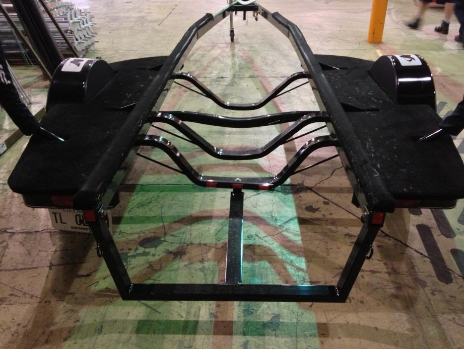

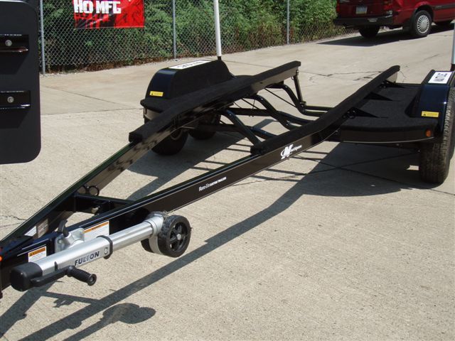

      I have a 2002 single axle Ramlin Wishbone trailer for my boat. It's a 2" ball and there is a 4 pin flat hook up for the lights. Mine has fluid controlled drum based surge breaks. I probably won't have my boat out of it's enclosure until Sunday but I can take some measurements then if nobody else has gotten you the info you need. I believe the widest point of my trailer is the guide poles and not the outside of the tires but the posts are only held on by two large bolts so they could be removed easily if needed. These images were snagged off of google image but my trailer is similar to these:

              My trailer measures 97" (2465mm aus), from outer wheel arch to outer wheel arch.

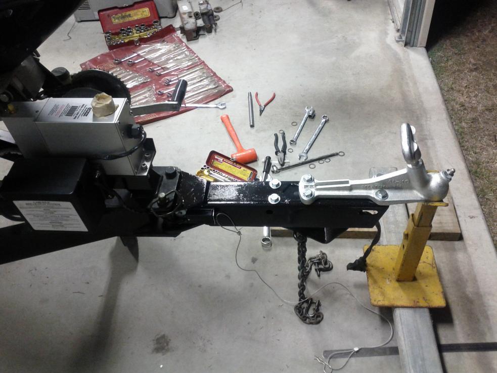

              I rewired the trailer front to rear with LED lights, Hydrastar and breakaway system. All strait forward 12v wiring. In Vic I believe you also need an independent handbrake.Click image for larger version
Name:	Trail rite trailer.jpg
ID:	366060 If you look close you can see where they had to cut off the wheel arches to fit in the container.

Name:	Hitch, swing away draw bar.jpg
ID:	366061Click image for larger version
Name:	Hydrastar mounted.jpg
ID:	366062Click image for larger version
Name:	Aussie Hitch 50mm.jpg
ID:	366063Click image for larger version
Name:	Backing plate and new disc.jpg
