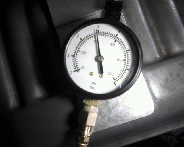

    There has been a lot of questions about GT-40 fuel pressure, and or driveability issues.
    This is how I check mine.

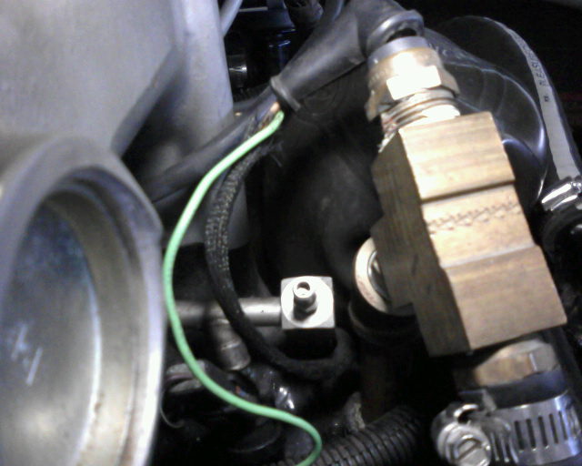

      Fuel pressure

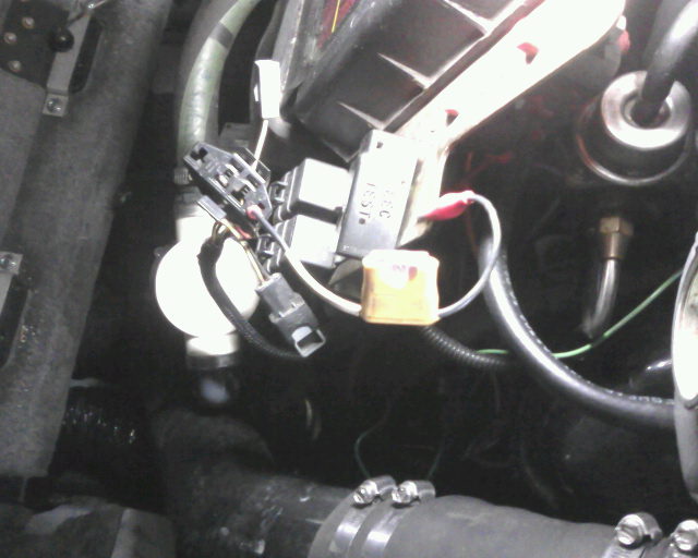

      what is the third picture? where does you inline pressure guage go?

        RE: Fuel pressure
        That is what the third picture is for, the guage connects to the shrader valve as pictured.
        I would think the computer is PCM proprietary, so good luck...but who knows.

          I have not needed to get a computer connection to my boat, Yet. I think the connection in the picture that I put to ground is a standard Ford connection. There is a possibility that a Ford OBD1 testor might plug into it, and pull codes.
                  Looks like a standard Ford EECIV to me. PCM doesn't do anything to the ECM's from GM or ford. Well, except for eliminate the O2 sensors.

                          I know this is really old, but DanielC can you comment on what fuel pressure is at different times.
                          key on, not started - not mentioned in the manual
                          Idle - from gt40 manual I think this is about 31 +/-3
                          WOT - from manual 39+/-3
                          • DanielC
                            • Nov 2005
                            • 2669
                            • West Linn OR
                            • 1997 Ski Nautique
                            The fuel pressure regulator uses manifold vacuum to cut back the pressure at idle. At idle the vacuum is high. Key on, engine off, manifold vacuum is low, and fuel pressure is high.
