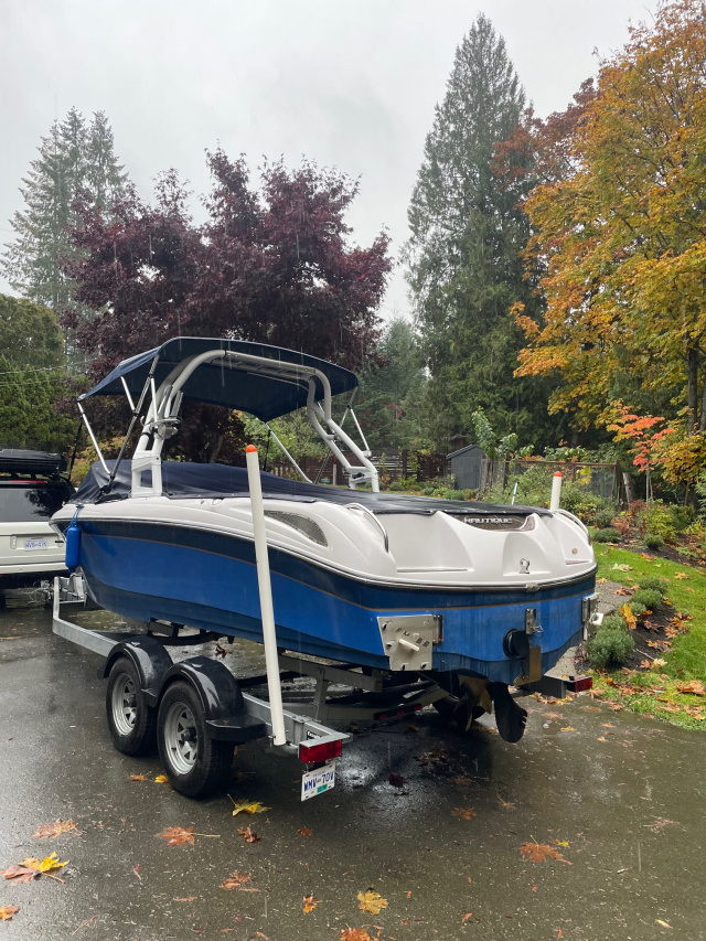

                        #41
                        Made a lot of progress and learned a lot about "single boat theory" this season. Geez it'd be cool to have a ski and a surf boat but we are pretty much at a) tournament ski performance 28-35off and b) consistently great surf formula. I keep looking at surf boats ('23 S23 $150K = good deal) but managing two boats is a real headache for me.
                        The props make a difference on how the transom sits: 381 ski, 645 both, 1433 Surf. Just have to figure out how to change in the water . Which I have done once before.
                        The pylon was a game changer for skiing. FMSS surf plates I'm going to amp up the deployment as they produced the best wave under full ballast. I am going to add more lift and side dig by routing the paths. .
                        This boat does way better if listed so the V bottom is flat on the surf side.
                        I'm going to see if I can get the surfboard shaper to make me a platform at like 15 lbs. I could also reduced the weight of the engine cover.
                        Simple equation is Weight out = ski, weight in = surf.
                        Had a great ski set to close out the year, a few days after surfing... not a bad wave at all:
                        https://www.instagram.com/p/DQatwaUkZSb/?hl=en
