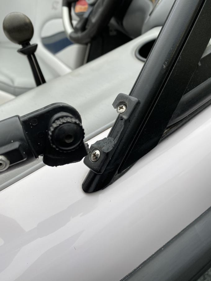

        The Bimini mount also broke, are these replaceable?

        • SilentSeven
          • Feb 2014
          • 1955
          • Bellevue WA
          • 2004 Nautique 206
          #64
          I've found there are lots of sources of bimini hw if you search. Here's an example....
          https://www.westmarine.com/bimini-hardware-parts
          Sent from my Pixel 3a using Tapatalk
          Bellevue WA
          • Stevemo14
            • Apr 2019
            • 691
            • Columbus, OH
            #65
            There all kinds of brackets on eBay too. Just search Bimini Hardware.
