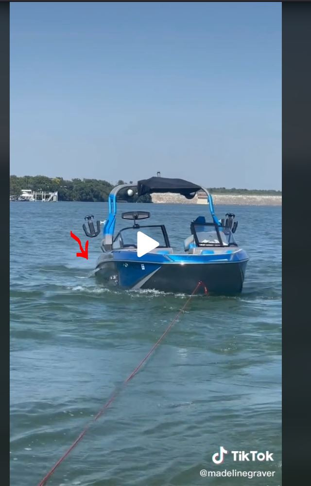

    Who needs pics when we've got a tiktok video? https://www.tiktok.com/@madelinegrav...67534846561542
    Hmm. So interesting....boat was undertow, bilge pump was dumping water (see pic) and still decently high in the water. And it sank.
    Suggests to me some sort of catastrophic leak - thru hull failure...ballast system...engine inlet water hose....hull perforation of some kind...what else could it be? Hard to think of anything else that would let that much water in.
    BTW, I'd dope slap the kid that pushed that vid. BAD FORM I say!
    Edit: Also, judging by how quick everyone was off the boat (when it was still high in the water), I'd say they had a pretty good idea it was bad - what else would lead you to abandon ship? My vote is they hit something and punched a hole in the boat.
      from the comments...
