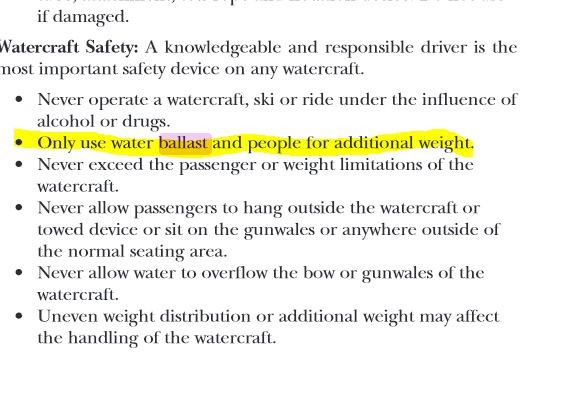

                          Re lead in the boat and buoyancy...wouldn't be surprised at all to find something that speaks to this in the fine print of the Nautique documentation. Anyone have the most current stuff and want to poke around?
                          I'm not an engineer but from recollection, lead pigs will have a very different buoyancy effect when underwater than a water filled ballast tank. I would expect the ballast tank to be almost neutral as the volume displaced is near the mass of the water. Pigs on the other hand will continue to be very negative when submerged and maybe to point to exceeding the factory buoyancy safety margin. If Nautique's lawyers haven't yet included this as an exclusion in the documentation, I bet they are thinking about it.
                          Edit / got curious. From page I-85 in the 2021 Nautique manual.
                          Click image for larger version  Name:	nautique-ballast.JPG Views:	0 Size:	64.5 KB ID:	639201
                            I'm not an engineer but from recollection, lead pigs will have a very different buoyancy effect when underwater than a water filled ballast tank. I would expect the ballast tank to be almost neutral as the volume displaced is near the mass of the water. Pigs on the other hand will continue to very negative when submerged and maybe to point to exceeding the factory buoyancy safety margin. If Nautique's lawyers haven't yet included this as an exclusion in the documentation, I bet they are thinking about it.
                            I believe steel loses about 13% of its weight when underwater. 500 lbs of steel would be about 435 lbs under water.
