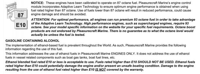

            From the 2021 PCM Owner's Manual:
            Looks like all supercharged engines require 93.

              What's crazy is you can't even get 93 in Utah only 91 is available. I know at elevation you don't need 93 but if something where to go wrong with the motor while under warranty, could they void it for not using 93 octane? I have over 750 hours on my XR550 all with 91 octane and not one problem.
              I put a deposit on a 2021 G23 and will be getting it with the ZZ8, so I'm just curious how they would handle this.
              This is from the Manual
              WARNING: The XS550/XR550 Supercharged applications REQUIRE the use of premium 93 Octane fuel. Failure to due so could result in poor engine
              performance and engine damage that is not covered under warranty.

                The unspoken truth here is that the number of marinas that carry 93 Octane fuel rounds to zero. And many who buy the Paragon live on lakes and do not trailer. In 2020 in the XR7 engine manual there was unmistakable verbiage which stated that use of fuel with octane rating less than 93 would void the engine warranty. If you look carefully that verbiage has been removed for the ZZ8. Thus octane booster would be one choice for those who do not trailer...
