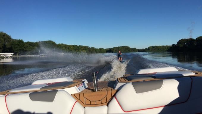

                  This is a pic I lifted from a PN member who tested out a GS20. Hopefully he contributes to the conversation, but here's the slalom wake (can remember if it was 32 or 34). I won't speculate on your needs, but I do not consider this wake remotely feasible for course use.

                    That doesn't exist. I'm a former world ranked slalom skier, AWSA driver and judge, and a current World Champion surfer. If you move to a boat that has even a reasonable surf wave you will suffer at 22 off and shorter line lengths. You can get mediocre ski wake performance from a surfable boat but not a tournament level ski wake.
