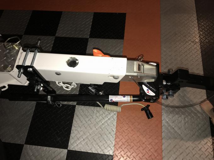

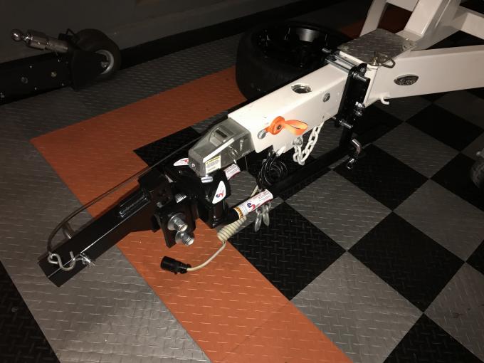

                Its the fastway e2 with round bars. Has to be round bars. The brackets to hold the WDH bars need to be back a minimum 20" from the center of the ball. Shortest setup I could find. What this means is that you can run the tension bars IN FRONT OF the fold away tongue joint. This alleviates the concern that the trailer mfgs have over having all the WDH tension bar stress on the joint of the fold away tongue joint.
                Heres what im working on. It's not tested or installed yet work in progress.

                  This setup above I plan on running at a low level of spring if that makes sense. I really don't need much but this is a setup mainly to CYA as far as checking the boxes of proper tow equipment. I'll report back when I actually try it out.

                      I never used it, I actually returned it all. Instead I got a weigh-safe hitch, that's the hitch with a built in tongue weight scale. My tongue weight with level trailer was exactly 650 lbs. My Yukon specifies that the tongue weight can be up to 600lbs without a WDH, so I figured I was close enough. It actually tows great.
                      I spoke to a nice guy at Equal-i-zer hitches. I showed him this hitch setup in previous post. He thought it was ok and feasible. He suggested that I get a pole tongue adaptor to "widen the Y" if that makes sense. He saw no reason that I couldn't use a WDH with a folding tongue when it's made from steel. I would use the WDH setup shown if I was towing with a F-150 or other vehicle that requires WDH with trailers over 5000 lbs.
                      Hope this helps a little.
