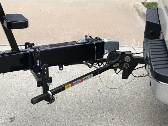

              G25, triple axle Boatmate trailer with no swing away tongue, surge brakes, F150 ---- Equalizer WDH with a pole tongue adapter
              I had to remove the bottom ladder step and mount the pole tongue adapter on the bottom side to get everything to line up correctly. Works great. Only downside is it will scratch through the trailer paint at the mount point.

                @Bbevostein, that's a slick set up, nicely done.
                  Bevostein - do you have a link? Thanks!
                  @all - is swing away mean you can unlock and tuck the tongue away to save space? If so my trailer has it. If boatmate doesn't recommend a WDH what is the alternative?

                              See page 24-28. Raptors always have a lower tow rating because of the suspension. Would love to have one but not at the sacrifice of the towing capacity. Keep in mind that's the requirement to be legal. Personally I wouldn't hesitate to use a Raptor to cautiously tow a G at reduced speeds a few miles from a storage area to the lake. However I wouldn't tow long distances at highway speed since it would be outside manufacturer recommendation and could open you up to liability if somethings happens. There are two considerations in my mind and those are what is the vehicle capable of and the risk of what is defensible in court if something happens.
                              http://www.fordservicecontent.com/Fo...US_10_2016.pdf
                              The Equalizer hitch can be found here:
                              http://www.equalizerhitch.com/
