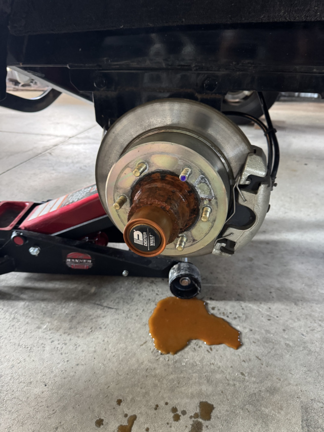

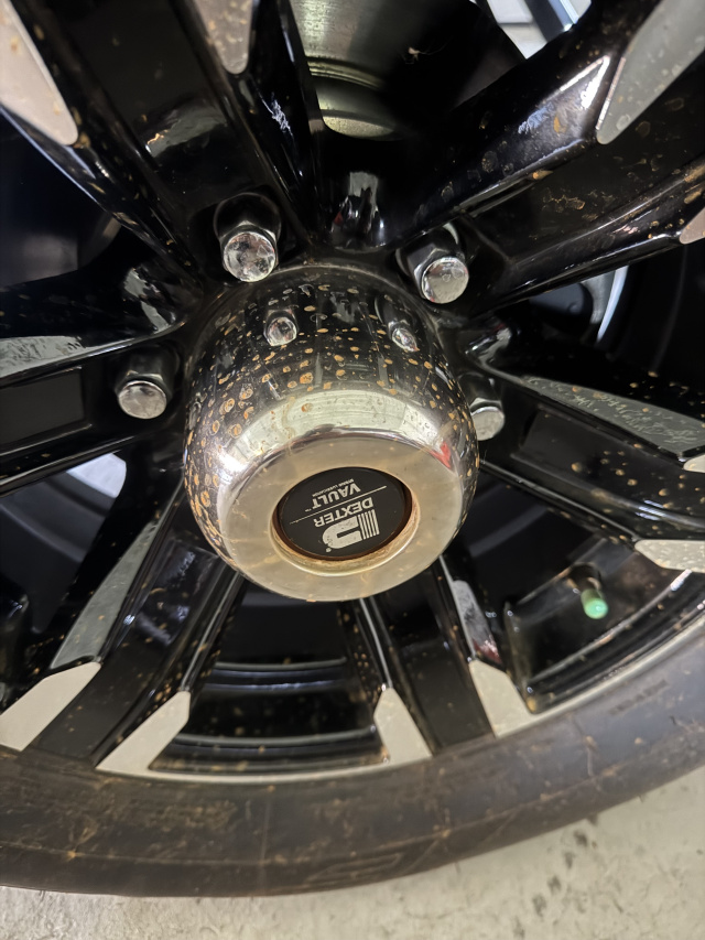

    Anyone seen this one before? I have a 2002 ski nautique and a few years ago (Feb of 2022) purchased a brand new trailer from boatmate. Recently I noticed rust shooting all over my wheels and trailer.. Started to work with boatmate who asked for pictures and to remove the wheels and inspect the hubs. When I took the wheel off I found the problem... The center bearing/hub covers were leaking and holding water. Terrible design on a boat trailer and don't think this part is even necessary! Should be covered under warranty, but dexter has already denied saying I've had a long slow leak..Yeah NO sh*T! I believe this should be covered under the trailer/boatmate warranty but wanted everyone else's thoughts.

        I had a similar (albeit not that severe) issue with similar caps on mine. I drilled a few small holes around the base of each cap to help evacuate water.

          I just pulled off my rims and tires to replace my 6-year-old sneakers and found the exact same thing. I would not consider this a "leak" as there is an obvious space on the face of the beauty cap. This is a design flaw.
          I greased the area as I figure out an alternative, but seeing this, I am going to remove and/or replace the caps with something that does not hold water. Or, maybe I will paint them black.

              Not a leak thing for sure (those aren't sealed) like Srock mentioned, but maybe tight enough to hold water for way too long.
              I like the drill a few holes idea. Out of sight, out of mind, until it starts spewing orange goo.

                Yeah, I don't think the caps are even needed and personally don't think they look any better with/or without. I would recommend anyone who has those caps to simply remove them. Boatmate is sending me the bearings, caps, vault covers, vault hybrid grease, seals etc.. Just in case the water leaked into the actual bearing/and hub assembly. I haven't removed the hubs yet so don't know what kind of shape they are in. Though when I towed to the lake this past weekend, the hubs seem to operate normally, warm to the touch (not hot) no play and when jacked up appear to roll just fine. Won't know for sure until I open them up. Also I agree, definite design issue! Let's in water with no way to fully drain.
