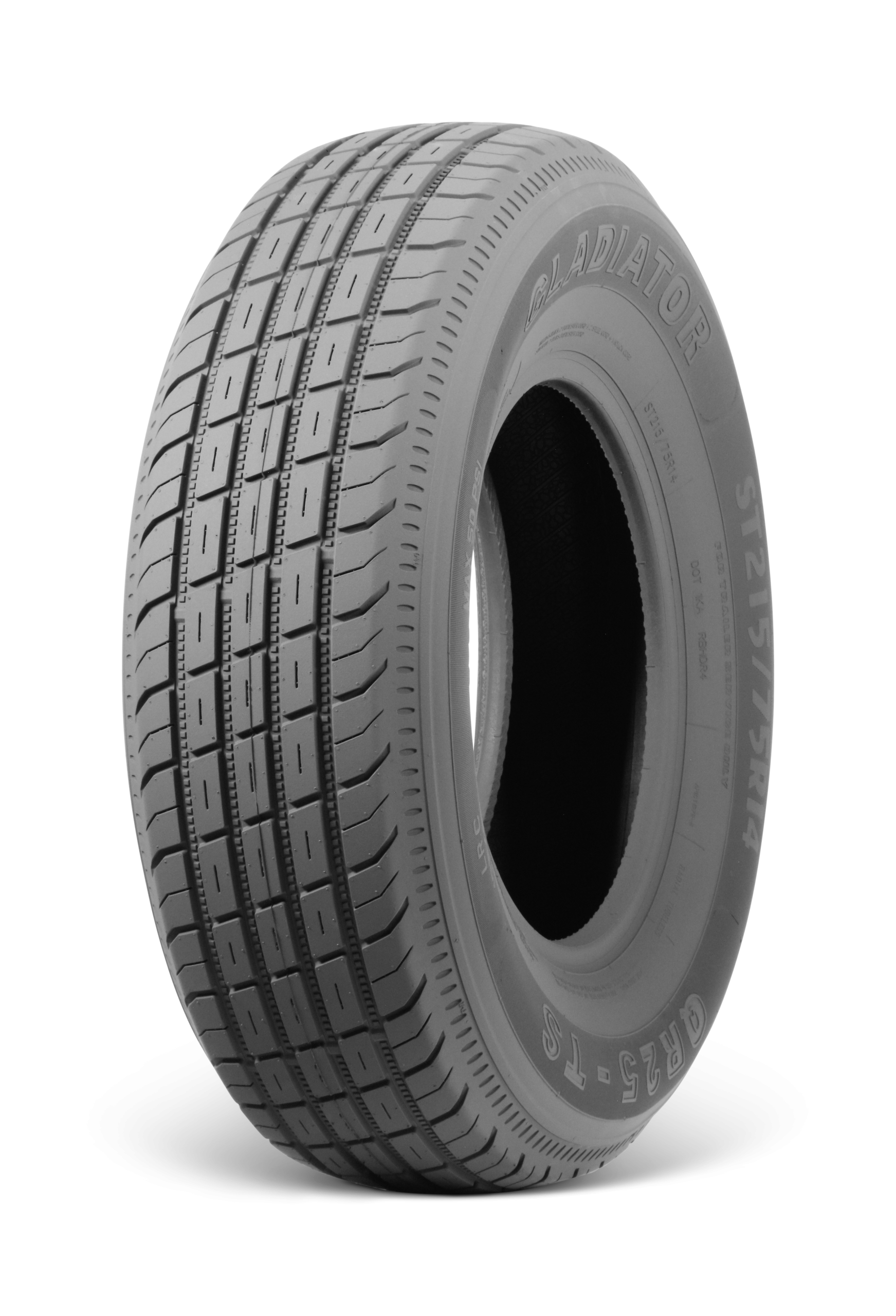

                Adding on to this thread...
                Need some input here. My spare tire blew out while sitting on the spare tire mount. Time a for a new tire and since the other trailer tires are about 7 years old, I was going to get new ones all the way around (single axle).
                My current tires are Kenda S550 series in a load range D. I have been very happy with these tires. My trailer place I trust, and have purchased multiple sets of tires from, has the Kendas but now carries the Gladiator product. The 'guy in the back' said they are better highway tires and last longer. I hate switching brands of tires on my vehicles and surely am not in the mood to switch tires on my trailer because the guy in the back said Gladiator is better. Anyone have experience with either. I know the Kenda tires were discussed here before, but I don't recall the census on them.
                My size is a 205/75/R15 and I use a range D.
                http://gladiatortires.com/tires/trailer/qr25ts/
                http://specialty.kendatire.com/en-us...loadstar-k550/
                ***The spare tire that blew was not a Kenda, but a tire from before the Kendas.

                  Update, it is a 225/75/15.
