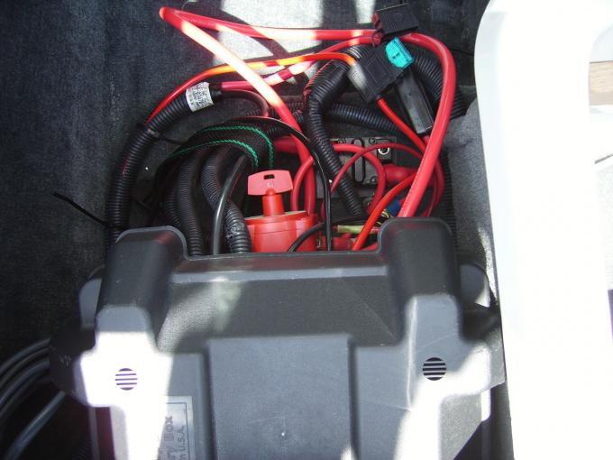

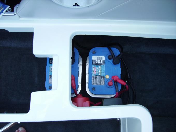

Probably one of the better "good example of a bad example" I have is from an 07 MasterCraft I worked on. This one I was told had a $3K stereo installation from a Professional Marine stereo shop that I've shown here before. Guess which is the before and after.
In the end if you don't get the basics right you'll end up spending hours chasing issues that may show up intermittently.
