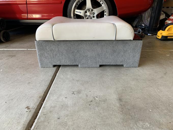

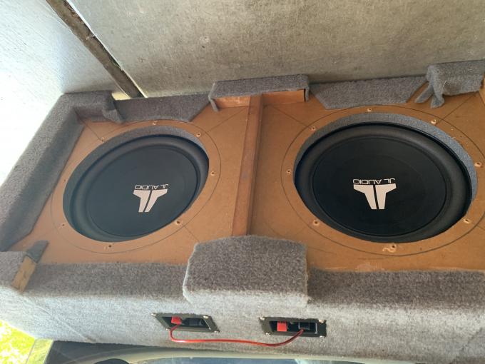

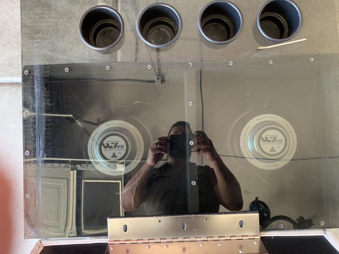

ID:	586578 I know this is an old post, but if you are still I. The market to upgrade your bass. I have a custom box that will fit your boat with no modifications. Click image for larger version
