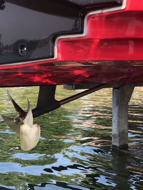

    Third times a charm... busted my prop up again hitting my lift bunks and looking for some advice. I have cantilever hydraulic lift with carpeted load guides on the side. The guides are set to the widest spot on the boat(rub rail). When the boat is lowered there’s a little play from left to right, if the boat ends just a little bit past the perfect spot forward there’s enough play for the prop to hit the bunks under the boat. I’m pretty cautious trying to avoid but it’s not always that easy. I’ve been thinking about adding from guides to the from or maybe a bow stop. Bow stop concerns me about scratches. Any thoughts?

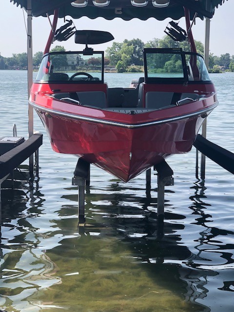

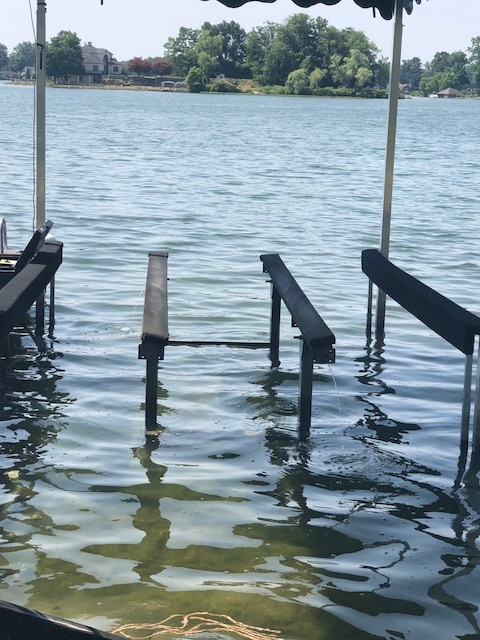

        Pictures below. This is a Basta lift and as far as I can tell I cannot widen the bunks. There also isn't a cross bar, it appears it's the bunks. I don't really like the carpeted bunks as they seem to scratch the side of boat at times. I'm thinking of adding these to keep me centered ( https://bastaboatlifts.com/product/c...g-guide-steel/) I could also add a bow stop( https://bastaboatlifts.com/product/bow-guide/ ). I'm not sure I'd need a bow stop if I kept the boat centered.

            Hmmm. With the boat guides staying on the frame, and not moving with the bunks - makes it a bit harder to line up with a marked spot on them, but it could still be done (but would be dependent on being unballasted, otherwise the bunks will meet the hull in a different place when they come up). With the way that lift is framed up, fabricating an alternative bow stop would take some doing, and the one they have is probably your best bet if you need one. Beyond that, I would just say make a habit of coming in very slow and killing your engine before you have a chance to tag a bunk with a spinning prop.

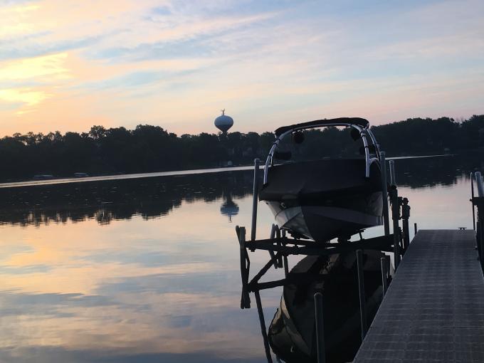

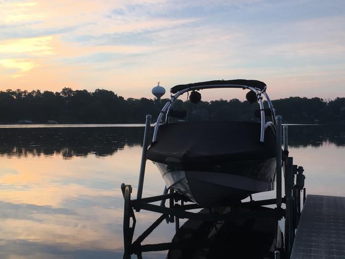

              Click image for larger version  Name:	CFCA1F10-6E49-4A7B-81C6-990D9BDE5A2D.jpeg Views:	1 Size:	34.3 KB ID:	562006 Click image for larger version  Name:	F863F4DE-13B1-4F23-98D5-FC25EB0EC01D.jpeg Views:	1 Size:	34.2 KB ID:	562005 Couple different ways to approach this and get a viable solution. You can add a bow stop to your cradle that will prevent you from coming too far forward should that be the issue.
              Those carpet guide ons I am assuming are wide so they don’t rub the decals off your boat when you pull in. Solution to that ........What I did to conquer that was remove the carpeted horizontal piece from the uprights and simply slipped a 3inch round pvc ( what I think was the size off the top of my head ) cut to my desired length around the upright with a cap on it. . This way it only touches my rub rail at the contact points and you can get the poles a little tighter to prevent slop left to right. Once my neighbor saw what I did ,,, he did the same to his cantilever for his 230 and hasn’t looked back
              Last solition is to shorten the rear part Jon of the bunk a bit , probably not the most popular , but it can be done.

                  Is it happening while you are driving the boat onto the lift or are you noticing it after the fact?

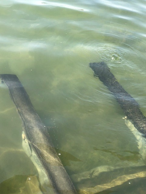

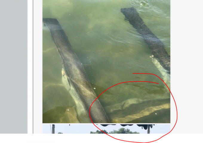

                  Have you gotten into the water with some goggles and just manually push the boat on? I have a hydrualic cantilever lift and I cut its close to the cross support circled below as the boat is lifting:
                  I doubt you are hitting your prop on the bunks. In order to hit your prop on those bunks, you'd have to be mis-aligned quite a bit i would think.
                  You could always shorten up the bunks as well - the really don't have to have them all the way off the back end of the boat
                  -martini

                    From everything I could tell the issue was hitting the bunks. The spot you circled isn't reachable by the prop. I ended up getting a remote control unit and it's working well. I just lower the boat until it's a spot a can reverse out. I then hit then raise the bunks up with a few bumps from the remote when I'm free. Now we I pull in the bunks are high enough to stop my forward motion and it also centers the boat. I then can slowly pull forward by giving it gas until I'm the sweet spot. So far it's been working!
