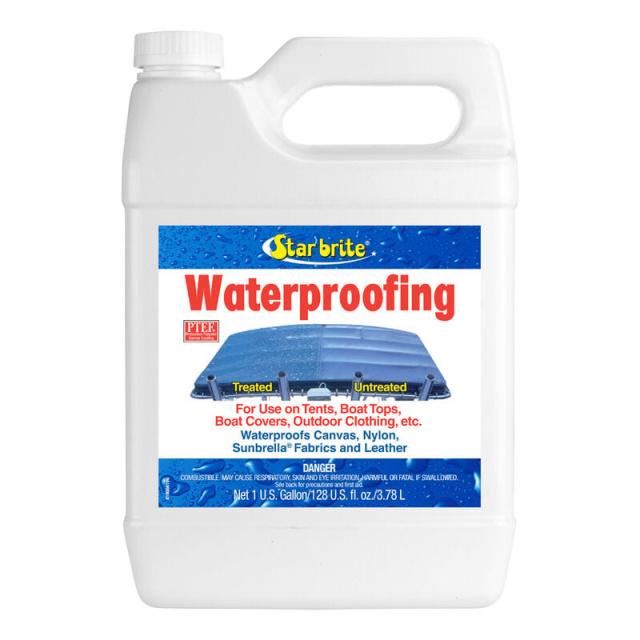

          This is what I use. I use and electric sprayer to apply to my Bimini top as well as my Mooring cover.
