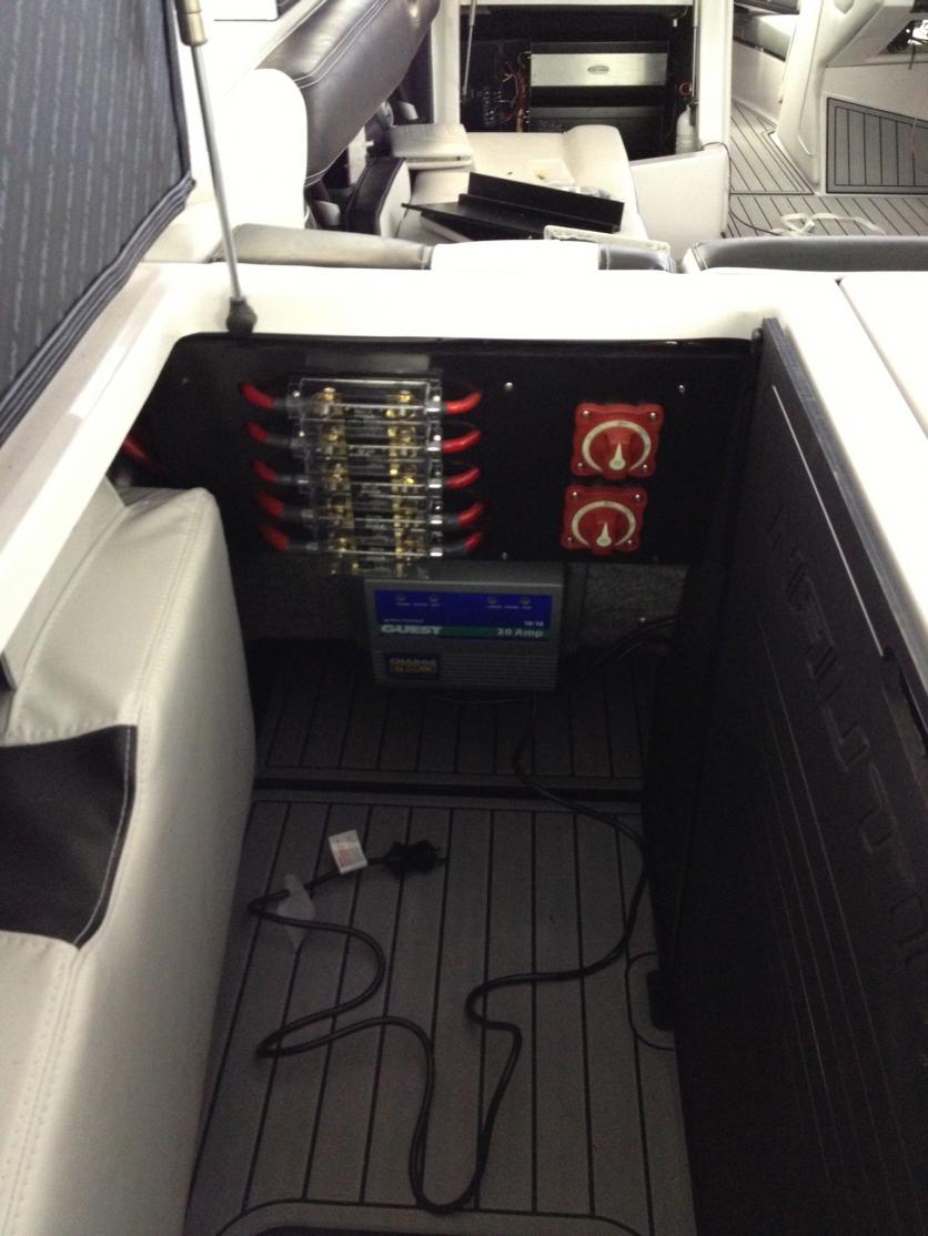

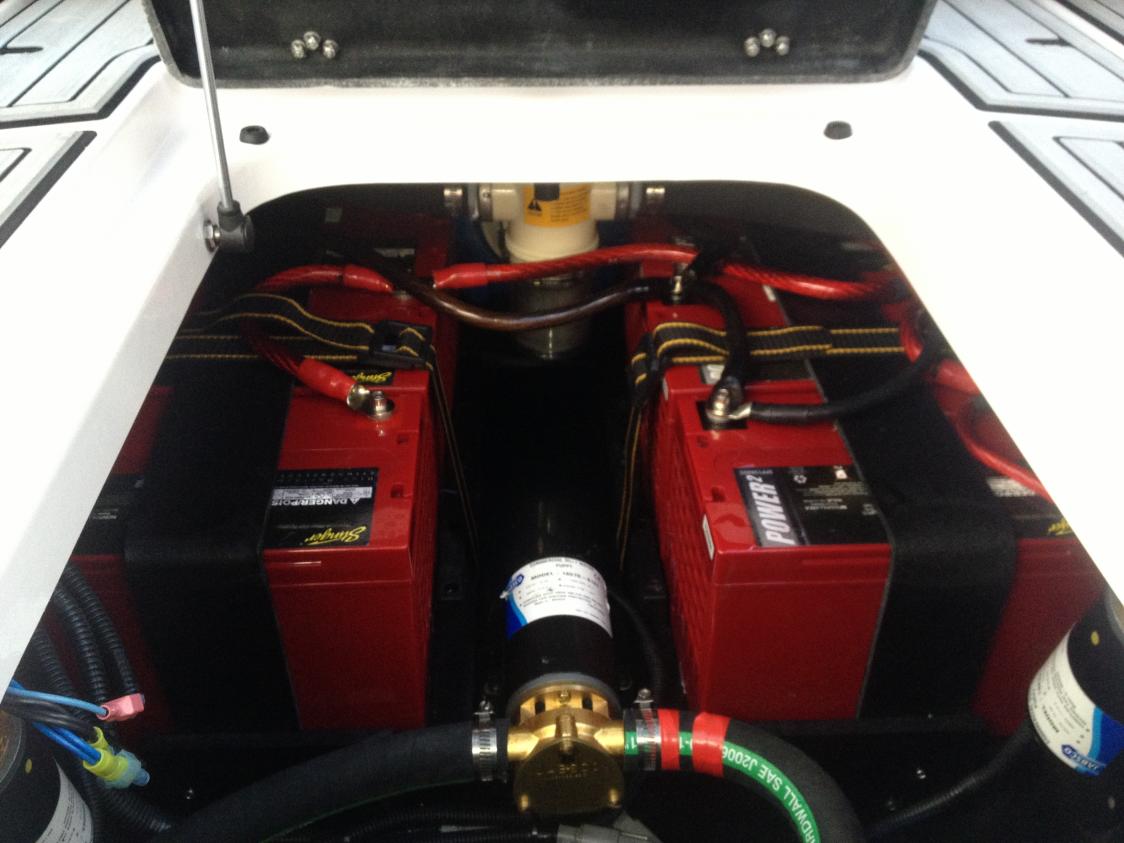

In the first pic you can see the power board for the system. It runs completely isolated from the boat powered by 5 stinger batts, with one switch for the sub and the other for tower and interior. One stinger is 100% for the boat/instruments. If that one battery goes down I have a positive cable ready to simply connect to the other 5 and move on. I love how they stored the batteries which centers the weight. In my 230, I had an issue with weight on one side.

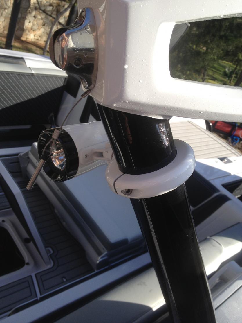

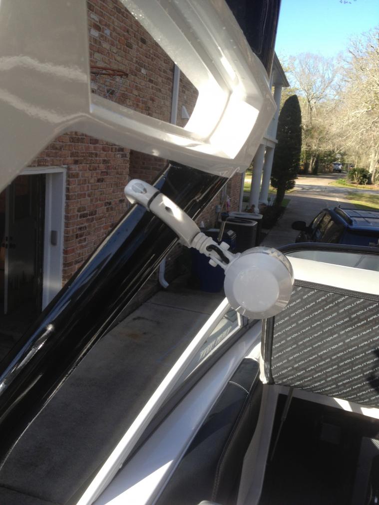

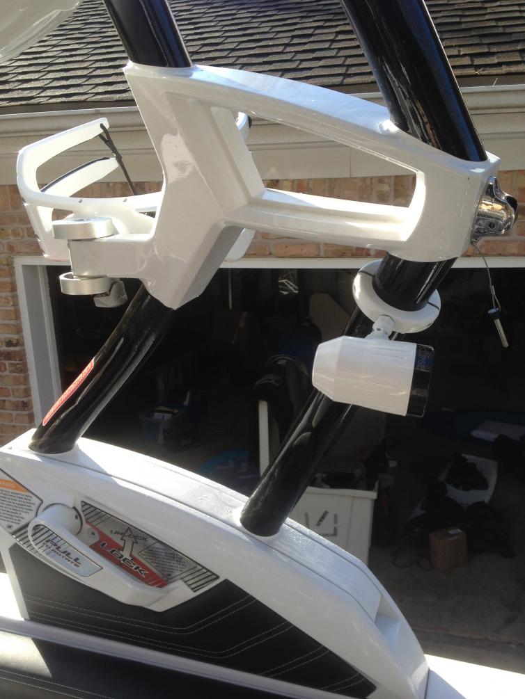

The next three pics are eclipse lights (2). I live on a bayou that feeds into the bay of galveston and the purpose was to provide more light for navigation. They completely swivel around and can point in any direction.
