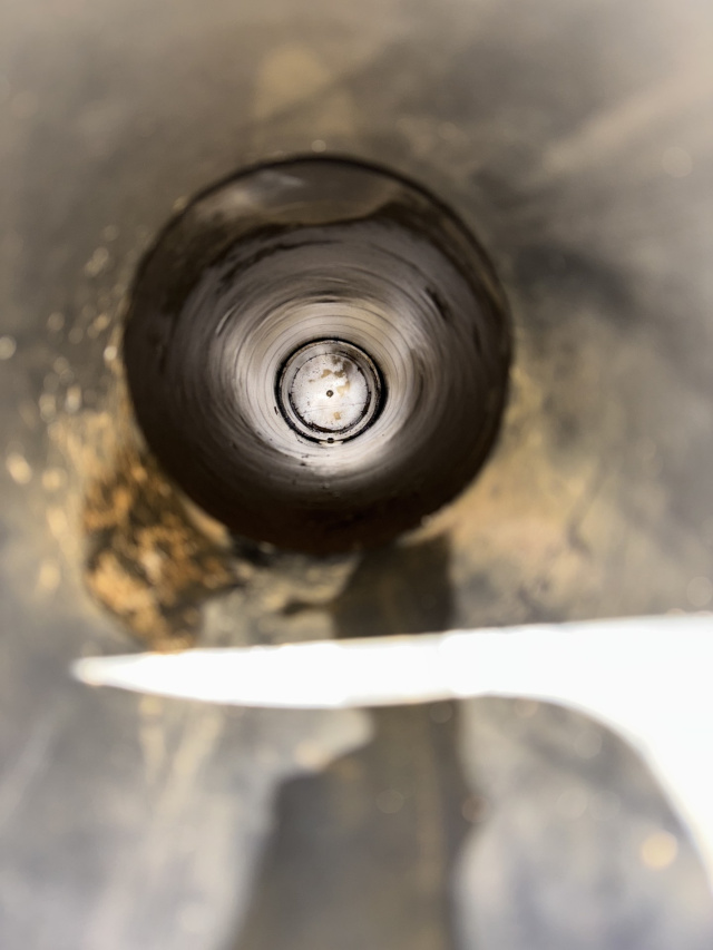

Since then, I've noticed that the port side riser is much hotter than the starboard one. I replaced the water pump impeller and also the thermostat. The problem is still there. I removed the two 3-1/2" flexible hoses at the riser outlets to push water from the two hoses coming from both side the thermostat, and the manifolds don't seem to be blocked. Then, I plugged one side of the two 3-1/2" hoses going to the muffler and pushed compressed air into the one on the other side. I noticed that there's a kind of stainless steel flap at the muffler outlet that doesn't seem to open. I then reconnected everything use a garden hose directly before the strainer and tested it with water. I noticed that water eventually came out of the muffler, but only around this stainless steel plate. How does this valve work? It seems like water is collecting in the muffler and is suddenly expelled out, is this normal? I have attached a picture of the muffler outlet where we can see the flap or exhaust valve..
