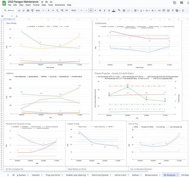

Name:	zz8 oil analysis Jan 2025.jpg
          Hello,
          Long time listener, first time caller.
          Anybody noticing oil dilution on the ZZ8? Across the last 155 HR's (89 - 244hrs) I've changed the oil four times with a fuel percentage of 6, 8, 5 and 4%. Ironically, wear metals (iron) spiked on the last interval which had the lowest dilution rate (4%) but I'm keeping an eye on causation vs correlation here.
          The oil analysis is per Blackstone Labs, but my understanding is they tend to underestimate oil dilution.
          PCM and Union Marine have both told me "not to worry and enjoy my paragon" when I've brought this to their attention. Pretty underwhelming support by the dealer.
          I should have the analysis back of my previous two oil changes of the summer next week and will make a decision on my next steps from there.
          For context, I put ~1500 hours on my 2008 Malibu LSV 23 running the 383 before selling it to a good friend. The oil samples on that thing are still "boring" compared to this ZZ8.
