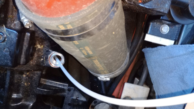

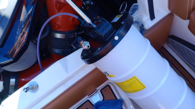

    I’ve mentioned it before, but the must have here if you are changing your own fluids is a pressurized oil extractor. I use the 2 Uncles Extractor and it comes with a multitude of different size lines and attachments – Not affiliated and have nothing to compare it to.

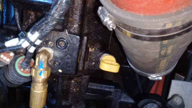

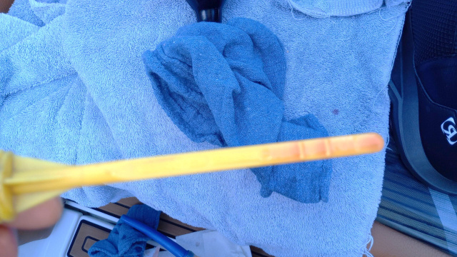

    Fluid was hot and came out super-fast with just a few pumps on the extractor. This is the 1st time I have done this, and felt around a little with the extractor hose to make sure I was on the bottom of the trans. I refilled at 1 ½ quarts, and then measured how much was extracted, 1 ½ quarts. The manual indicates 2 quarts, which means I left 16 ounces behind, hmm. Next time, I think I will run a smaller hose to see if I can’t get in a little deeper and measure the output. Open to suggestions if anyone has some thoughts here. In my mind 1 /12 quarts of fresh fluid is better than none.
    Dealer says they did a change out 2 seasons ago with Dexron VI, but that fluid looked pretty dark to me for only 2 Seasons?

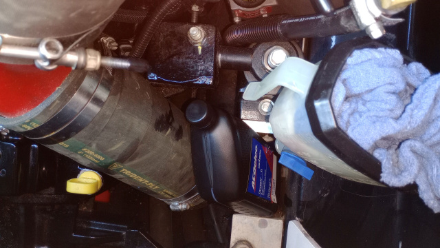

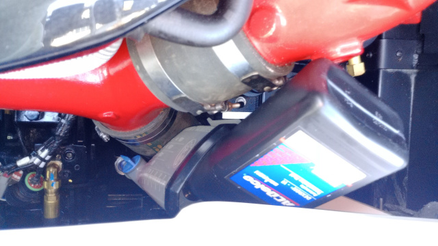

    Pretty straight forward

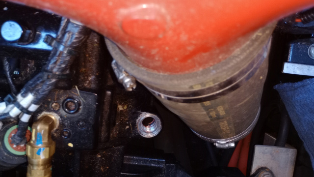

    Click image for larger version  Name:	4.jpg Views:	0 Size:	101.0 KB ID:	685355

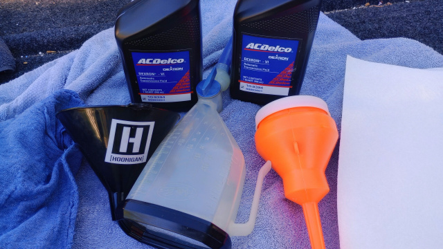

    Wasn't sure which funnel was going to fit the bill, but the adjustable measured unit in the middle was by far the best choice.
    Click image for larger version  Name:	5.jpg Views:	0 Size:	122.8 KB ID:	685356
    The extractor measure out at 1 1/2 quarts, so I figured out that is what needed to go back in.

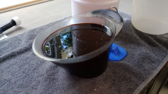

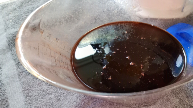

    Double checking measurement accuracy of the extractor, and visual inspection of the fluid.
    Click image for larger version  Name:	8.jpg Views:	0 Size:	109.3 KB ID:	685362
    Yup, 1 1/2 quarts. Does that fluid look a little dark to you?

                I had a piece of copper tubing left over from an ice maker waterline. A 12” long piece of copper tubing fit snugly into one of the plastic hoses on my extractor. I like being able to position the stiffer line easier in the dipstick hole and also don’t worry about losing a piece of plastic in the tranny.

                    Edit: Found it, the transmission dipstick is tucked back in to the right and behind the v-drive. Dipstick is red.
