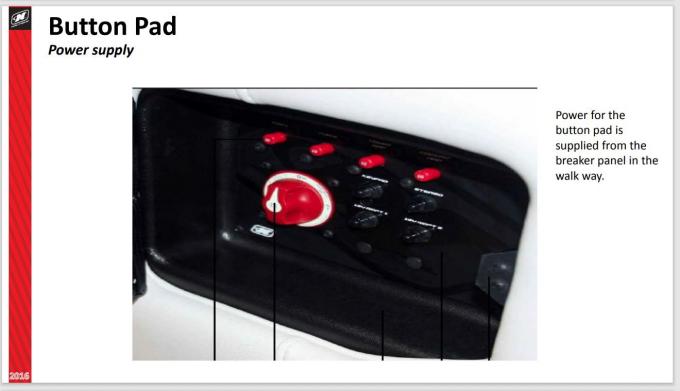

                I would start there then and use a test light or multimeter and make sure you have power to the battery switch. Battery switch is positive.
                • scottb7
                  • Aug 2011
                  • 2198
                  • Carson City, Nevada
                  See pic. Keypad get's power from battery switch. So if keypad not working then power probably not getting there from battery.

                    When I turn the battery switch from “off” to “on” I can hear a small click in near the engine. Which makes me think power is still getting there. Maybe just dead near panel? Trying to figure out how to attach pics I just took on my cell.

                      I think it's voltmeter time. Start at the battery and see what voltage you have there. Then go to the breaker in Scott's diagram and test for voltage on both sides of the breaker. Follow that to both sides of the switch with the switch in the on position. This will take you to the bus bar. If you end up with good power there you have something in the electronic circuitry going wrong like a bad Power Distribution Module or loose cable to one of them.
                      That a series of hard jars started this mess would certainly open the possibility that a cable or connector to one of the many electrical components could have been loose or not fully locked into place and has come disconnected. Since this is potentially a season ending event it certainly wouldn't hurt to start a one end of the power and nut and bolt everything. Start with the basics by insuring the ground cable to the engine and the power cables at the alternator and starter both look good and are properly connected. Work your way up the electrical system from there. Look for any loose wire connections, any cables that may be pinched and check all connectors you come across to ensure they're tightly connected.
                      Believe it or not it typically the simple stuff that ends up being the cause of issues like this.
