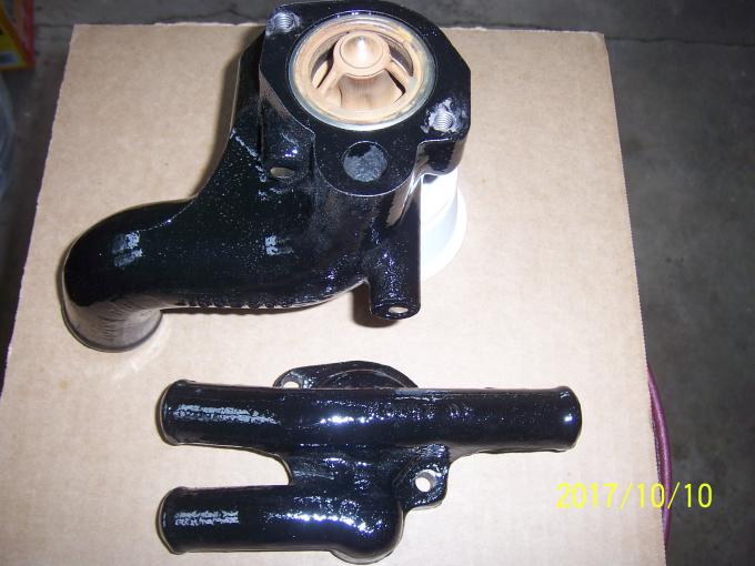

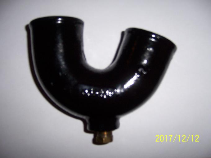

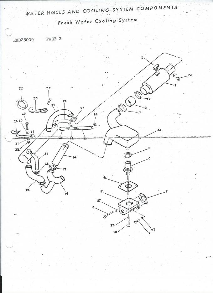

    You have parts of a fresh water cooling system normally used in salt/brackish water. Rather than have the water your in cool the block it uses a heat exchanger 11A in the diagram below to transfer block heated antifreeze to the raw water. That is mounted on the starboard side of the engine below the height of the sparkplugs. Connection in the back top is a T where the water from the outlet of the heat exchanger gets diverted into the exhaust manifolds. This is called a half system because the manifolds are still cooled by what ever water your in. You also need the Y, 16A in the picture and the surge tank, 1A. You could eliminate all that if you could find the parts in the second and third pictures,but then your engine will be cooled by what ever water you are in. First is the upper and lower thermostat housings,supposedly the lower is still available,upper can be found used sometimes. Third picture can still be bought new.
