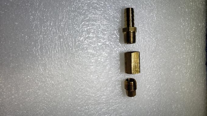

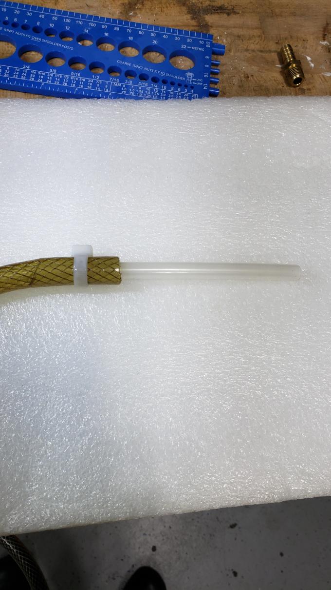

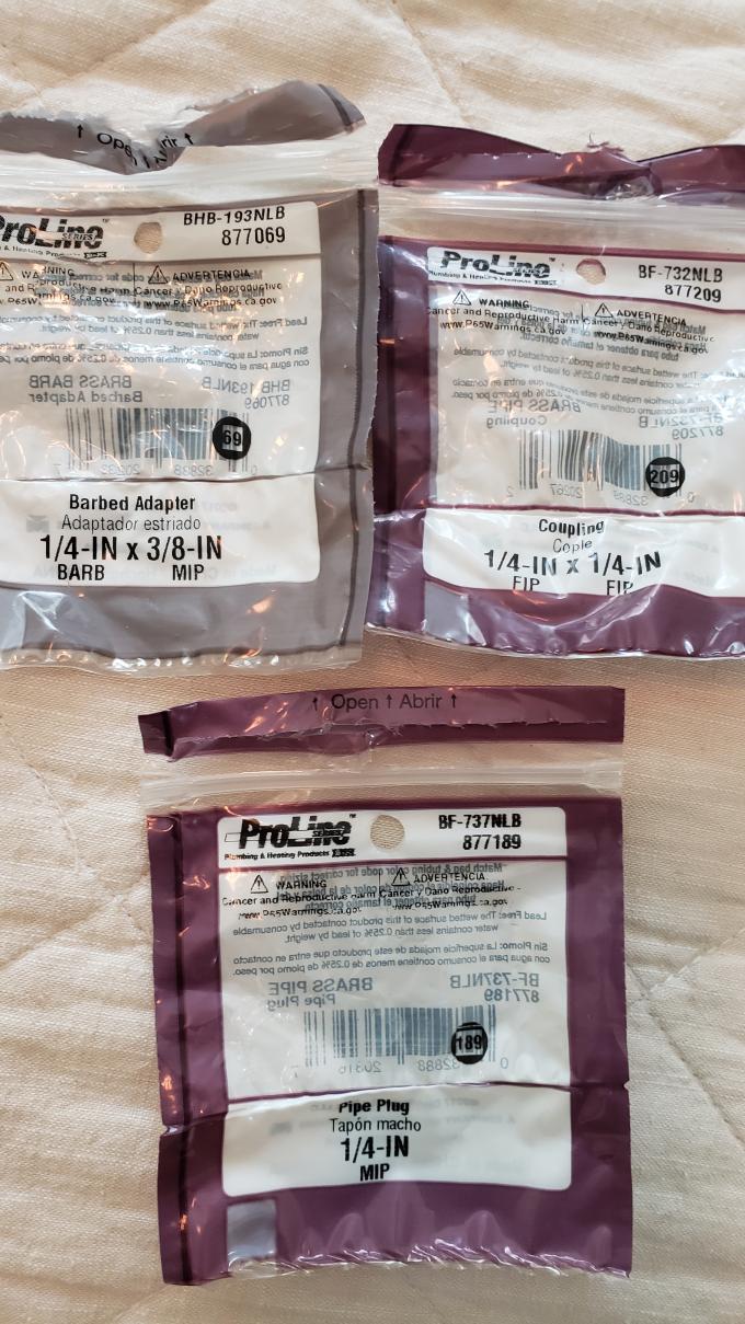

        I don't like to use the dip stick to extract oil because the hose can get stuck and there is no guarantee that you will hit the bottom of the oil pan. He should find the correct hose with an inside diameter that can fit tightly over the oil extractor dip stick hose and then get fittings to adapt the other end of the hose to the oil removal hose in the G. In the bottom of the hull, in front of the engine you will see a black hose with a brass plug. This is the oil drain hose. If he connects his oil extractor to this hose he will remove all of the oil and not worry about getting snagged in the dip stick. Here are a few pics and the parts that can be had at Home Depot or Lowes.

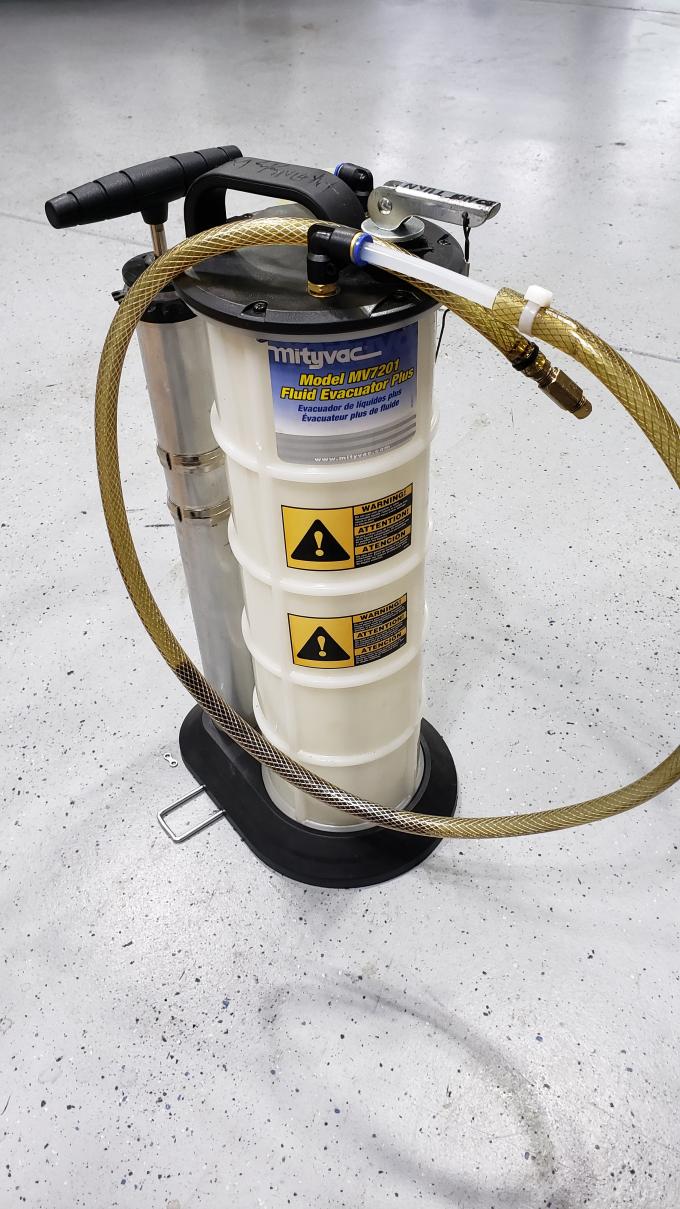

                Thank you greggmck, charlesml3 & NautiqueJeff -- showed your posts to DH and he understands what he needs to do now. Really appreciate your help, explanations and pictures. DH took some pictures of his work, and said he wants to post a write up on what he did.

                  Follow-up original post. DH was able to find a fitting he had on his workbench that fit on the oil drain hose and worked with his pneumatic oil extractor. Oil has been removed. Tomorrow he'll finish! Can't wait to get out on the lake!
