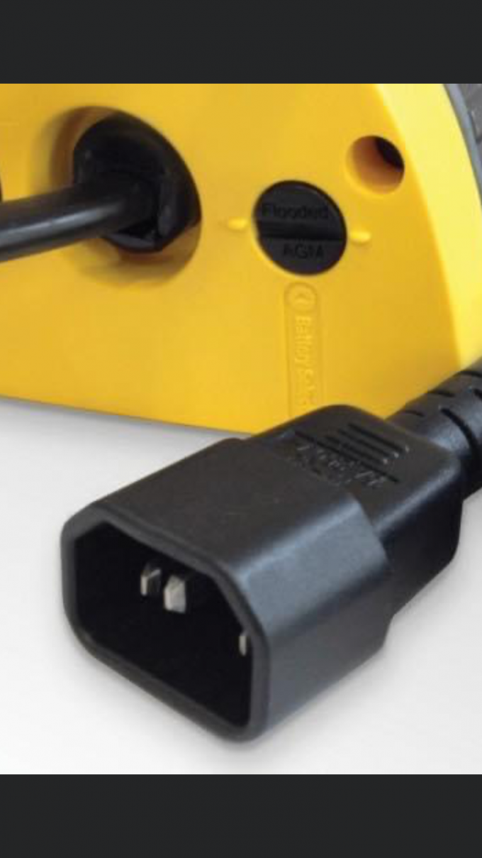

                Does your G21 have the onboard ProMariner charger?
                check this plug on the side by removing it with a penny. (Little back one in the pic)
                it should be the Correct color programming plug designated for AGMs.
                if it have a different color plug... your beef is a faulty install. (Assuming you have Deka AGMs like I do)
                the wrong color plug = an incorrect charging profile for AGMs.
                (I think I’m getting these colors right- verify for yourself!)
                “3 Charge Profiles – User selectable performance charge profiles for: Flooded(lead-acid)/STD AGM, GEL & High Performance(HP) AGM.”

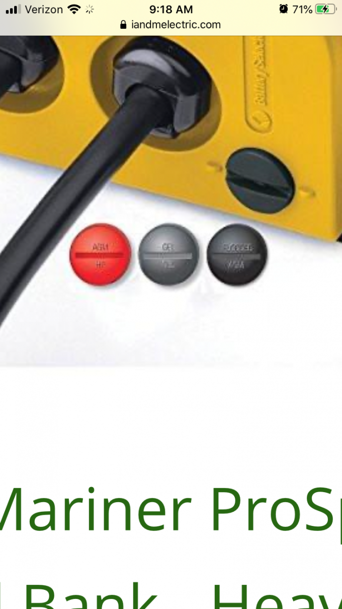

                    it should be the RED programming plug for AGMs.
                    if it have a different color plug... your beef is with Nautique for a faulty install. (Assuming you have Deka AGMs like I do)
