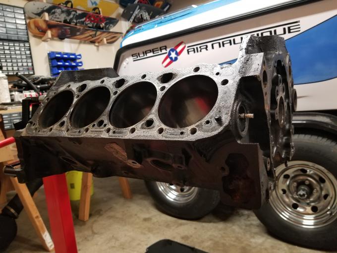

    I have a 2000 Super Air with the PCM 5.7 that I am in the process of rebuilding. The motor seemed to be getting a little worn out, 600 hours on the clock, and also developed an oil leak that was getting slightly worse every year.
    I am sure I will have some questions along the way, and am hoping to use this thread as a means to gather useful information.
    Firstly, as I am pulling the motor apart, I am wondering if it had been previously swapped with an "automotive motor"
    I did some research on the differences, and what I came up with was that the marine motors (long block) only have a few minor differences. Brass freeze plugs, non steel head gasket (stainless?) baffle in the oil pan.
    The freeze plugs and head gasket, are steel, or at least have enough iron content to be magnetic.
    My main concern is if I go to rebuild this motor and it is an auto motor, is there anything else that I should be worried about? Corrosion resistant valve guides? anything else to check for to see if it is a auto or marine motor?
    Block casting number is 10243880
    Pic for reference

    600 hours is very low for a rebuild. I talked to PCM years ago they said the only difference between the automotive and marine engines are the bolt on accessorizes. Freeze plugs , exhaust manifolds ect.

        600 hours is pretty low for a rebuild. It was mostly the oil leak, which was primarily coming from the timing chain cover and getting the timing chain cover off, required pulling the oil pan and that wasnt possible in the boat, so I pulled it. And now that it's out I'm thinking might as well give it a refresh at least.
        The hours had me suspicious that someone swapped it, or did a half *** rebuild job.
        The steel freeze plugs seem to be a consistent item that points to it not being an original marine motor.
        I'm looking into local machine shops. I will probably have them hot tank the heads and block, deck the heads, I will probably do the rest. Debating them regrinding the valve and valve seats, and replacing the guides if necessary. Trying to keep this a pretty budget refresh though.

          If I recall correctly, the 2000 models didn’t come with the 5.7 gm block. So if that’s what it has, its prolly a secondhand or remanufactured someone crammed in there. Good luck with rebuild

            I confirmed that they did make the PCM 350 for the 2000 model year, it was just a rare option, most came with the 351.
