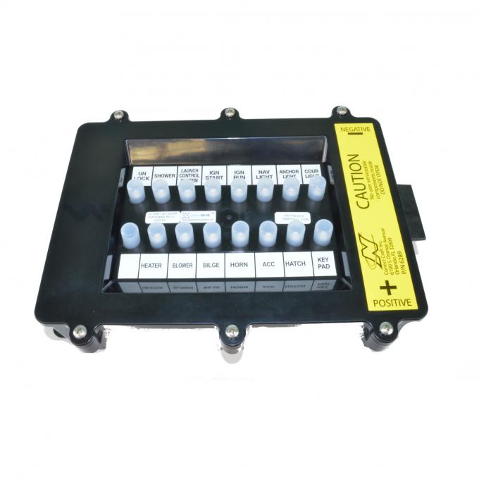

    Start at the most simple -- Check the circuit breaker for the Launch Control System at the PME box. If that's tripped, reset it.

      I will double check that but I have swapped the breakers around with ones I know are working and it did not seem to fix anything.
      The breakers have not been tripping recently. Do you think its possible I need to replace the whole breaker box? It looks like there are relays on the board inside the breaker box but I believe they are soldered on. I didn't want to tear the box apart to get to the backside of the board to check if I didn't have to.
