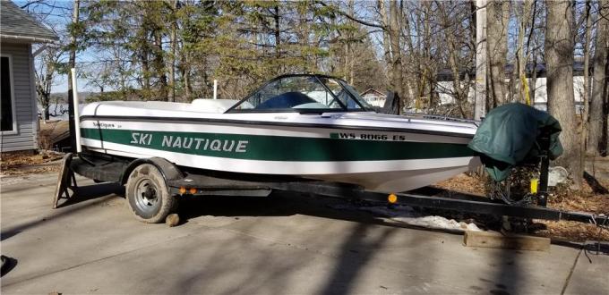

    New to me '99 SNOB. Replaced the prop(old was dinged). Very difficult to remove, used puller, heat, and force w/ wood block and hammer. Eventually popped off, to find key rusted in prop. Installed new ACME 422. Took out and water tested(1st time) - fired right up, engine seems to run well. Boat has obvious vibration when applying throttle, vibration lessens a bit at speed.......is this a prop/driveshaft issue? Or possibly a rough running engine issue(GT-40).
    Driveshaft turns easily by hand when on trailer, very little play if any at all.
    While on lake, revved engine out of gear, sounded good.....thoughts?
    Should I start by replacing plugs, wires, distributor cap, and rotor or look into driveshaft issues? Thanks! Learned a lot on here already.
