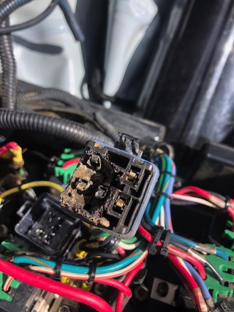

    So I have been through three relays for my Belly and Starboard Ballast Pumps and at some point one of them actually fried the coupling part along with the relay.
    Has anyone had recurring relay issues and or seen something like this? Little concerned there is some short taking place in the Battery switch panel or between there and the pumps.

        It seems to be more of a short somewhere because as soon as I pop a new relay in and hit the button it blows the relay...

            The solution was to replace the entire electrical panel in my boat...they tried numerous things at the shop but In the end decided to simplify the process and replace the entire panel.
            I think we determined there was so much corrosion that it was shorting out in places we couldn’t find. But now the pumps run perfectly. Hopefully your issue has a much simpler less expensive fix.
