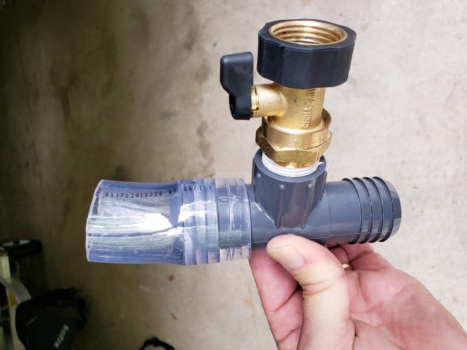

            Picture?

              Click image for larger version  Name:	20190515_145312.jpg Views:	0 Size:	36.4 KB ID:	583103
              Here's the pic. Clear end to strainer outlet, hose removed from strainer (to water pump) hooked up to other barb. Turn hose on and all water flows backward out through the thru-hull the second the engine starts it pulls it all into the cooling system. Took Sather's advice and just kept it temporary. Less places for a leak. Thanks for all the great tips.
