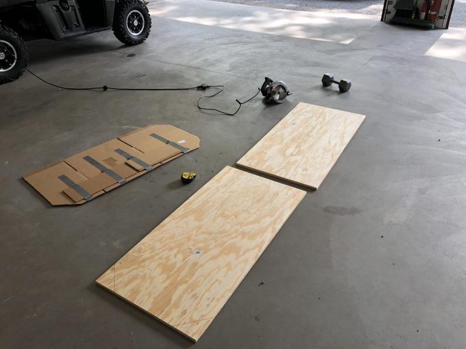

    After fitting this kit to my 210, along with the engine divider support kits, the factory aluminum parts gave out quickly. I tried doubling up the reinforcements (also from wakemakers) and they all bent just the same. This thread will show you the $25 fix that has been bulletproof so far.
    You’ll need:
    2 sheets (24”x48”) of 3/4” Thick Plywood (for you guys in the Midwest, these are about $11 each at Menards)
    ———note that I plan to replace the plywood with polycarbonate sheeting (1/2” thick) later this summer. The wood is merely a “weekend saver” fix for me.
    2 Pool Noodles (the thin ones) 48” long

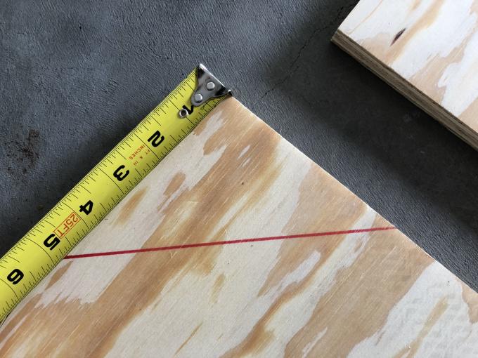

    The plywood needs to have the corners trimmed to fit in the compartment. Using a cardboard template, I found that cutting a 5” x 5” corner (45 degree trim) from each corner fits perfect. You’ll need some sort of saw to do this.

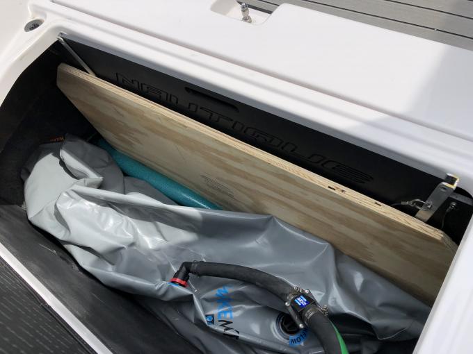

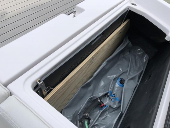

    Simply drop these pieces in next to your factory dividers and then tuck the pool noodle between the factory hard tank and the plywood to hold it in place and to prevent the ballast from sliding into the crevice and lifting the wood.
    check the photos below for more info.

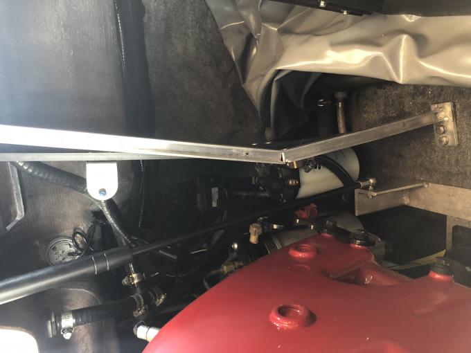

    I have the WM ExactFIT bags for my 230 and figured they wouldn't be immune to bending the panels. Because the WM panel savers are backordered, I decided to use 1" aluminum angle (1/8" thick). IMO it looks nice and does the job very well. I also found that I needed to adjust the starboard panel because it wasn't completely sitting in the lower track. All of this, combined with an additional pin in the rear vertical track, has made things solid.
    Sent from my Pixel 2 using Tapatalk

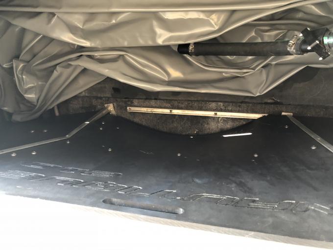

      Mine bent in the other direction... my vertical members were what gave out.

        Ok, I finally got the pics to upload properly..
        • tachyon
          • Mar 2012
          • 96
          • Stillwater, MN
          • 2001 Super Air Nautique
          Of course I uploaded in a totally non-relevant order... sorry about that.
