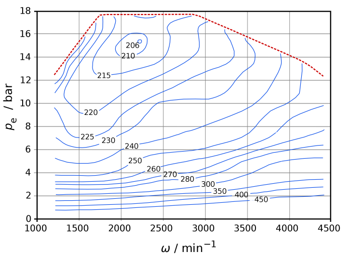

                      With all of these posts going on, I thought I would try to post something here that better explains fuel consumption at different speed and load conditions in an engine. In engine development, the attached graph I is referred to as BSFC map. (Brake Specific Fuel Consumption) map. This is a generic graph I found on line but is a good representation of what happenes in an engine. I tried to search for something for the GM Gen5 small black engine (H6) engine but these are not usually made public. To explain the map, rpm is on the x axis and engine load is on the y axis. The plot in the chart represents the fuel consumption for a given power at the engine load and rpm. As you can see the most efficient portion of the engine map is near full load. One primary effect of this is the throttling of the engine. When you throttle an engine you restrict the amount of air that flows into the cylinder. This makes the engine actually work harder to pull the air in to the cylinder. This effect is known as pumping losses.
                      This is what drives the idea of down speeding. For a given power, and engine will be more efficient at a higher engine load and lower rpm. So you can adjust a transmission ratio to have the engine at a lower rpm engine but a higher engine load.
                      Now relationg this to our boats. To push a boat through the water at a given speed it takes a given power. By changing the size and pitch of the prop we can adjust where the engine run on the map. This is easier in a car with an 8 speed transmission because we can continuously adjust the gear ratio to a more optimized range. In a boat the selection is more difficult because we have a single speed transmission and the inefficiency of the prop slippage. The efficiency of a prop and all of the subtle elements of the design could probably be a good thesis project but well outside my scope of knowledge.
                      Hope this helps people understand what is going on in these engines. Just remember on these graphs, the lower the number in the plot area, the more efficient the engine. Hope this helps.
