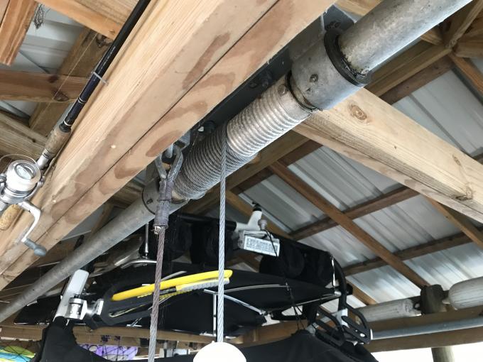

    I would be concerned about the cable coming off the sheeves - that is more angle than I personally am comfortable with... just my .02

      Add some cable wraps so they wind clean and do not get overlapped etc.

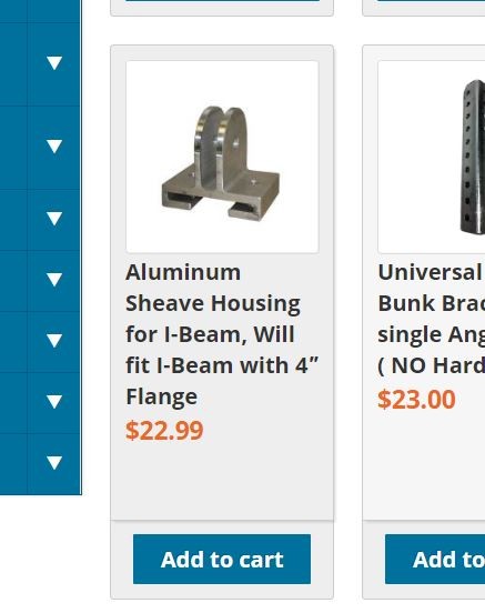

        I would straighten the cables and somewhere I saw an engineering reason for doing that. Below is a bracket option from boat lift warehouse or purchase stainless u-bolts. The Lowes near me had stainless bow eyes rated at 5,000# each for cheap.

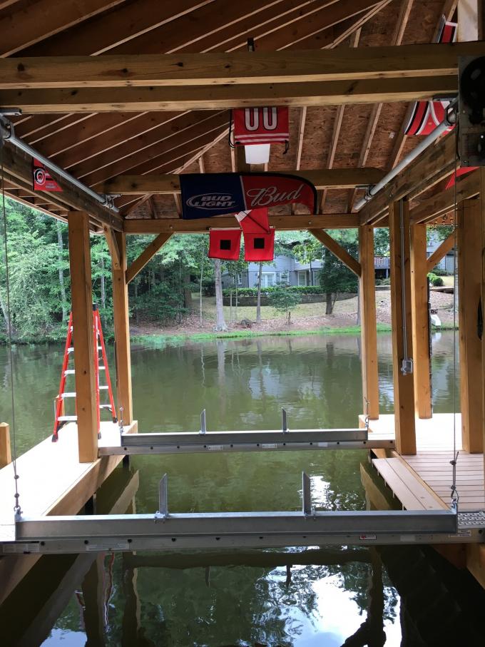

          OK, so the OP is replacing the lift now so not much of this matters anymore but someone asked about the changes I made to my lift for the 230. Here are the photos:

          Before the upgrade, there was only one motor and pipe on the right side. A set of cables went directly down to the beams on the right, and then another set ran across just below the beam, went through a pulley, and then down to the beam on the left side.

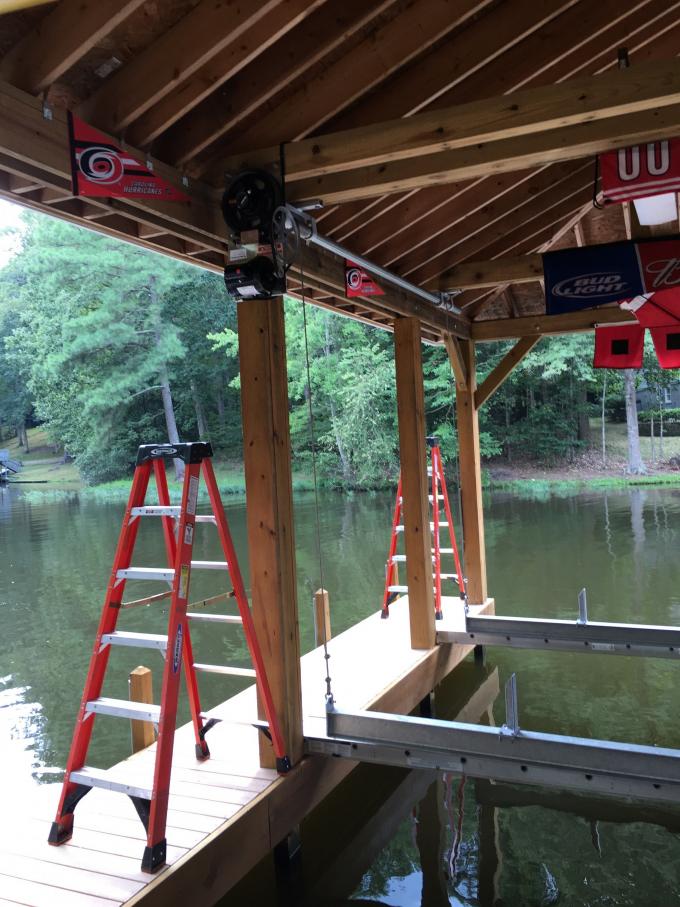

          Almost done. We added a new motor and pipe on the left side. This, along with new beams, cables, and bunk boards doubled the lift capacity to 6000 pounds.
