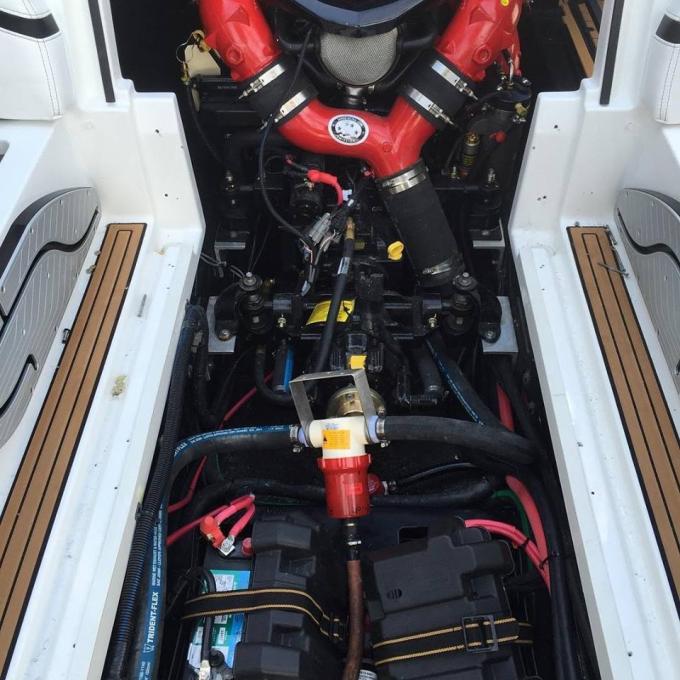

                        • Wildcat04

                          I’d love to see a picture of this set up to as well! Sounds like a real easy way to get water to the motor without a fake a lake or tearing into the raw water hoses.
                          • NautiqueJeff
                            A d m i n i s t r a t o r
                            • Mar 2002
                            • 17234
                            • Lake Norman
                            • Mooresville, NC
                            Here's a picture of one of these in a G23 with the floor removed.

                            • Wildcat04
                              • Jun 2017
                              • 43
                              • Wichita, KS
                              • 1997 Air Natique
                              Jeff, did you leave the strainer basket it or remove it when you used this method? I would assume using clean water from the hose the strainer wouldn’t be necessary.
