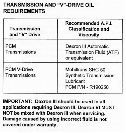

I'm about to get all of my 25 hour stuff done. I haven't t seen much on the board about preferred fluid for the transmission. My dealer is using Chevron MD3. PCM tells me not to use synthetic with the trans. What are people using? Thanks.
According to the manual for your engine, a transmission fluid change isn't required at 25 hours. You should just check the fluid and make sure it is full and clean.
If you do end up changing it, it looks like PCM is requiring synthetic in their V-drive transmissions, which is what's in all of the G-series boats.

They are two separate units. The V drive is essentially "service free". Dealers tell me that they are discouraged from even messing with them. As for the transmission itself, I spoke with Mark Snyder at PCM (the main guy). He says to make sure to use regular ATF in the transmission, as synthetic to too slick for plates in the unit. My dealer tells me they use Chevron MD3 (which is no-doubt an acronym for Dexron-Mercon III), and that it is best to change it at the 25 hour service. I also talked to Mark about the whole synthetic oil thing, and as detailed before, we can use synthetic to our heart's delight (in the specified weights, of course); just don't extend drain intervals. PCM, has been trying to say that it is overkill, given low operating temps and associated change intervals. I like overkill though...

According to this maintenance schedule it says that the transmission fluid should be changed at 25 hours and the V drive oil should be inspected, but only changed if contaminated.Originally posted by NautiqueJeff View PostAccording to the manual for your engine, a transmission fluid change isn't required at 25 hours. You should just check the fluid and make sure it is full and clean.
