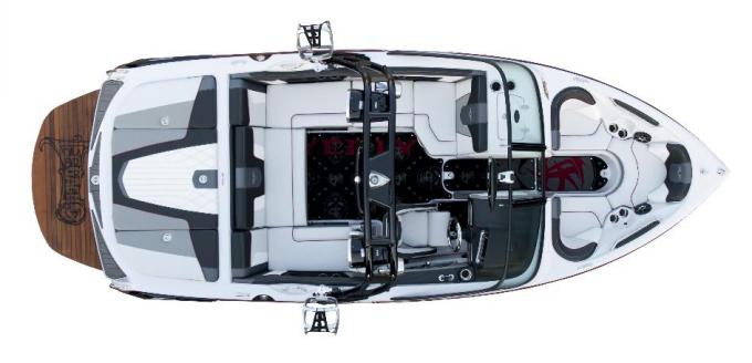

              Yeah Vision, I don't intend to cut into the transom so that pretty much limits height. After taking a few measurements this what I've come up with:
              If I use the same clearance from latch to edge as factory then the locker hatches will end up 190mm wider than factory (each side) so dropping the centre section by almost 16" giving me a 520mm (20.5") walk through. Here is a quick and rough photoshop to show proportions, before and after for reference.
              Standard 210 sundeck:
              Proposed sundeck with walk though:
              I chose a later model as I would probably trim the hatches like this rather than the older curve.
              Another thing I notices was the new 200V actually has a very shallow but still wide walkthrough and that looks good.

                Something weird is going on with those attachments. Here they are again.

                    That seems like a ton of work just for a 4" narrower look, since functionally everything under the the covers will still be the same. You would also have to retain the hinges and either run your center hatch under the edges of your side covers to keep it locked down or reuse the original lock or something similar. Why not reuse the panels and on the center one finish the center strip of it for Seadeck and then have 4ish inches of vinyl done for the edges? Similar look and less re-work and a new owner could still have it re-skinned without a ton of work.
                    Also excellent choice on the boat for the mock-up I didn't realize the front carpet had that read logo in it since I never see mine.

                      Jonsquatch, I realise that it is a fair bit of extra work, but like I said earlier, if it's not going to look like it came from factory then I won't even bother and to me putting a strip down the middle of the engine hatch looks a bit half assed, as does replacing the centre section with seadek. I intend to re use the latch mechanism for the centre section, sorry I left that out of the photoshop.
                      I have also decided that if I go ahead with this I will probably keep all 3 hatches in tact so the project could be reversed if ever desired.
