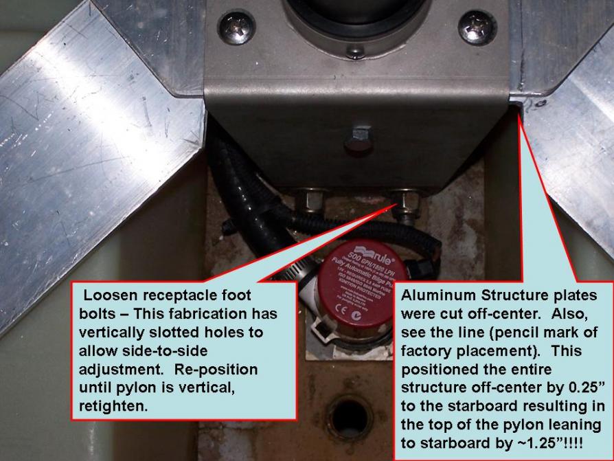

Does anyone know if the removable ski pylon (200V) mounting structure (in the floor) is adjustable? Noticed my pylon is leaning off center to starboard.
Tags: None

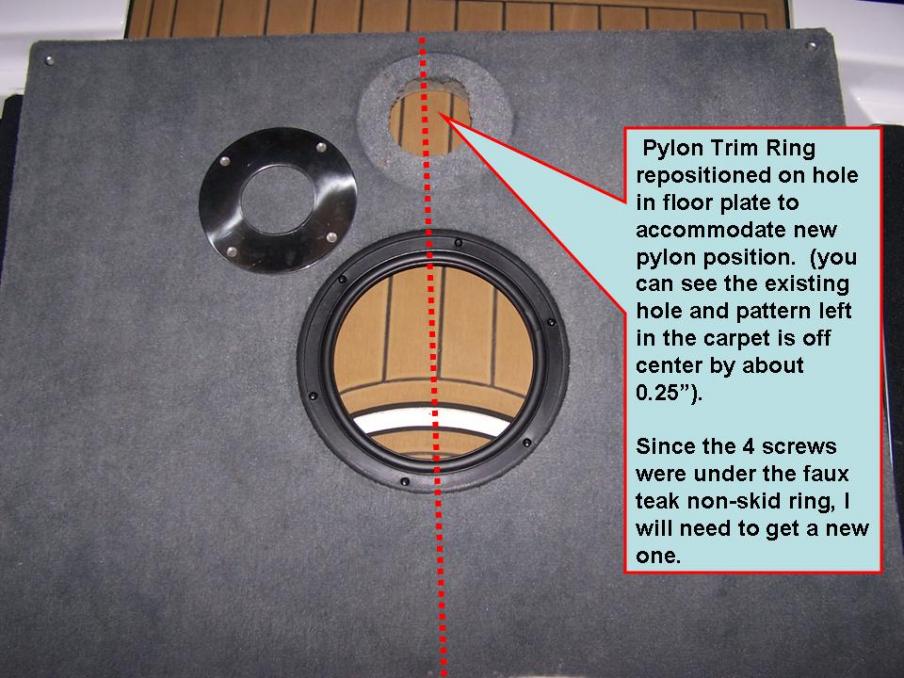

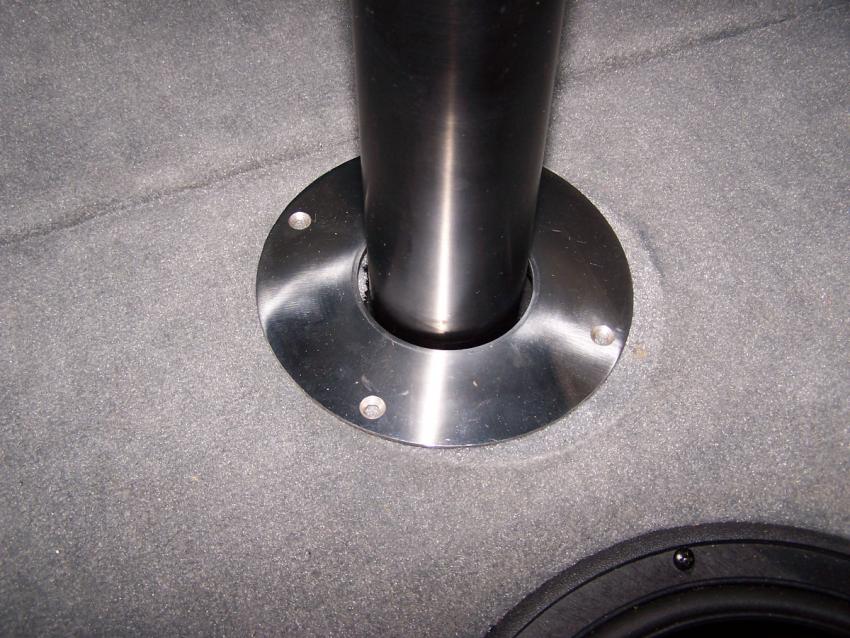

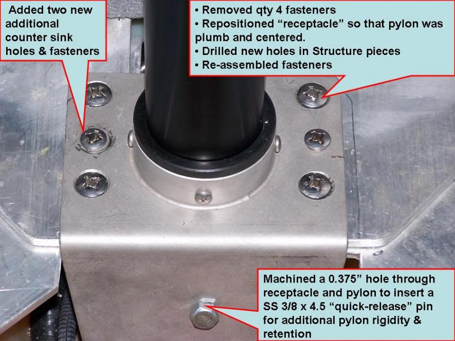

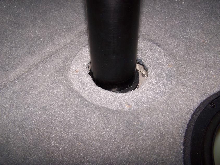

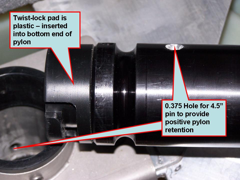

Ok...got yancy during the Thanksgiving weekend and decided to dig into this myself. Bottome line, there is very little adjustment possible and while investigating my situation, decided to fix the problem and add some enhancement. This should also help answer questions for all those 200V owners wanting to know whether a barefoot boom can be attached to the pylon...and possibly why CC will not (or should not) endorse this?? (sse pic showing plastic piece on bottom of pylon). See photos:
Peace..

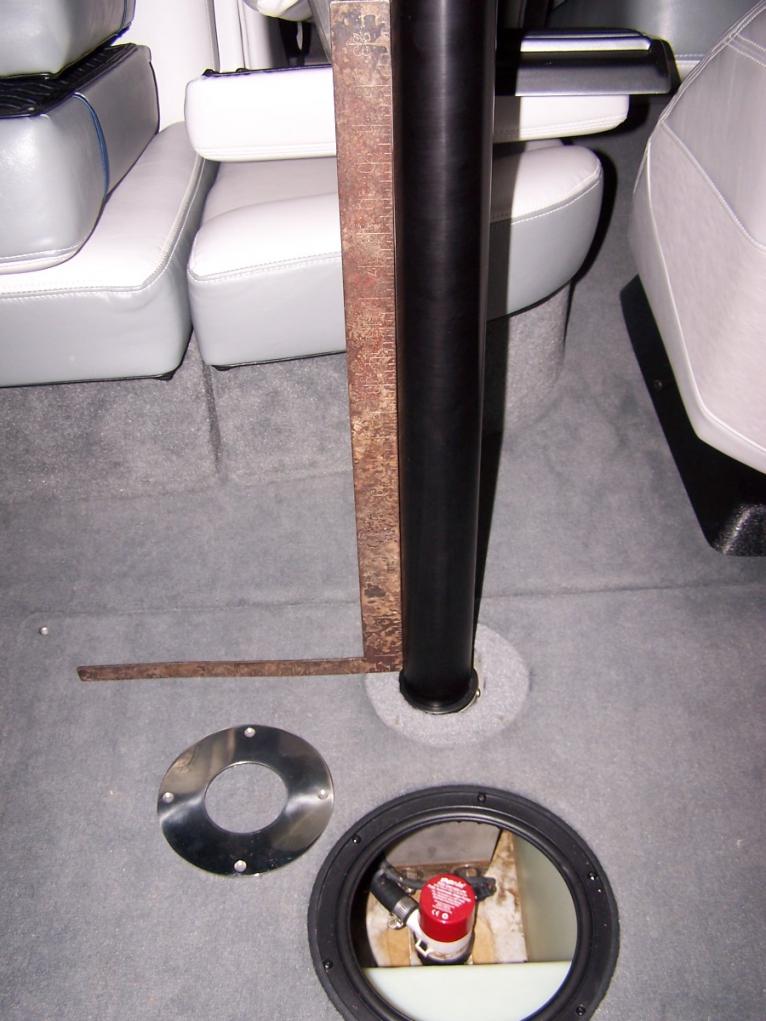

Some additional pics.
Pylon now square with floor:
Thankfully, the factory floorplate cut-out is over-sized to account for quite a bit of pylon position tolerance:
Trim ring re-positioned on pylon (notice how far out it was from prior position patterned into the carpet):
Down to final steps - re-fasten the ring, add new faux teak non-skid.Peace..

The reason I wanted to dig into it myself was to see what I could do to beef it up for a barefoot boom. I'm a bigger fan of a pylon mount boom rather than a tower mount boom There's been some other threads where folks have questioned putting a boom on this 200V removeable pylon...but don't remember anyone having too much confidence in it.Peace..

I have way more confidence than I did before the repair/mod. I'm confident I can now mount a boom with extensions and not have to worry...(hopefully I won't be made a liar very soon). The vertical force that a boom would put on the twist lock pin-to-plastic pylon foot has been diverted to a 3/8 thru pin that goes through both the pylon and the receptacle tube structure assembly. The existing 4-piece structure is pretty stout for fore and aft / side to side forces. Stay tuned...I plan to do some testing before it gets in the water.Originally posted by jeepn View PostSo after this repair, do you have confidence in using the pylon for a boom mount.Peace..
