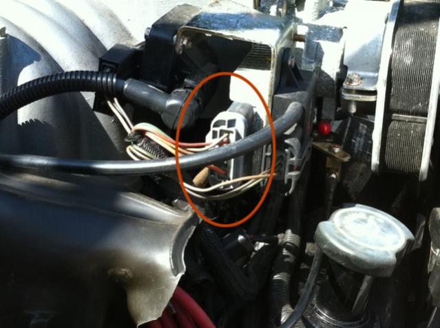

            HELP!!! Still not starting. I have done the following:
            1. Checked lanyard and wires behind lanyard. all seems good.
            2. Checked battery cables. They are tight.
            3. Checked fuse on a separate wire coming off of battery and it is good. I think this goes to the fuel injector.
            4. THE MAIN PROBLEM I SEE IS NO SPARK coming from the coil using the Ignition Spark tester I bought.
            5. A friend told me to check the ignition module to see if it was getting power. See circled area in the attached photo: ignition module. With the key on, I found it was getting power. Could the ignition module be bad? If so, are these readily avaialable at a NAPA store or do I need to special order?
            HELP, guys!! What would be next steps? Am I going to have to cancel my Monday wakeboard trip? Can you help me save it?
            Thanks!
            • DanielC
              • Nov 2005
              • 2669
              • West Linn OR
              • 1997 Ski Nautique
              #21
              No spark, no start.
              Go to the down loads section of this site. there is a Gt-40 service manual there. Down load it. It does have a good trouble shooting section in it.

                  Thanks, Jeff. I did go through the GT-40 service manual. Since I'm not getting spark, I suspect it could be the TFI-IV ignition module. Unfortunately I don't have the diagnostic equipment to test it and since it would have to be a marine part, I suspect I can't get one locally.
                  Are there other things that could cause the engine not to get spark? The coil could be the problem also.
                  Any way I can test these components? It was pretty damp when I took the PCM cover off the coil area. Could the dampness cause trouble? I left the engine open today to dry everything out.
                  We've planned to go to the lake on Monday. Can anyone save the day??!!
                  Thanks for your help!
