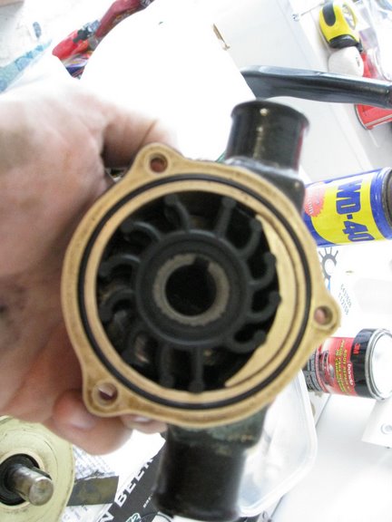

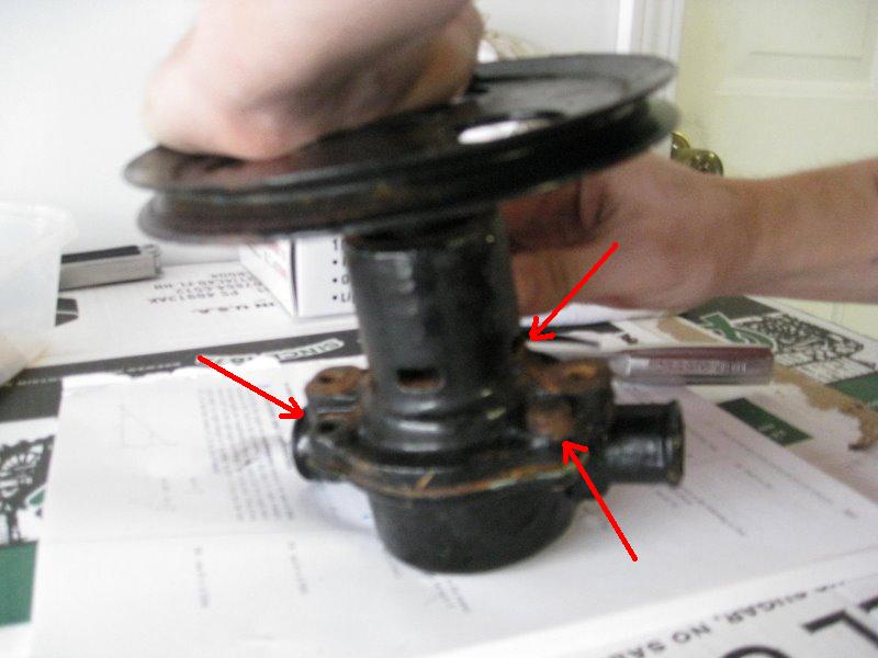

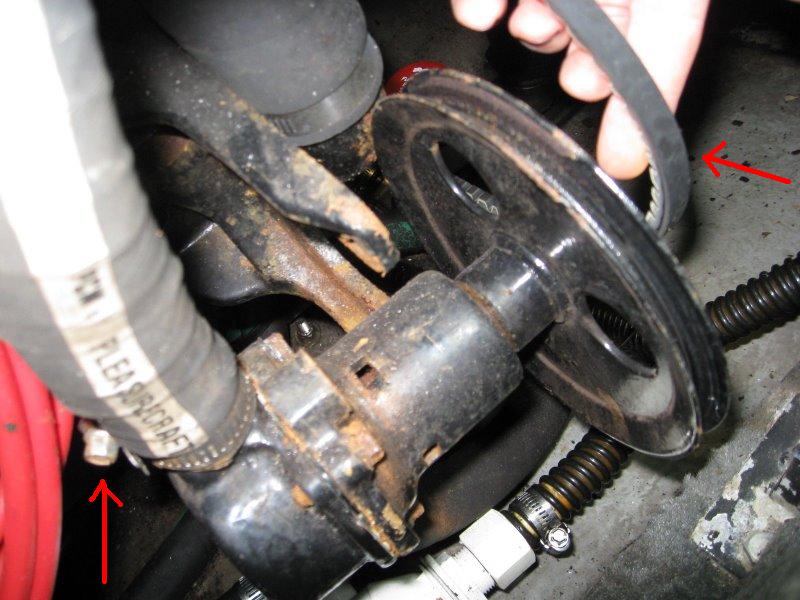

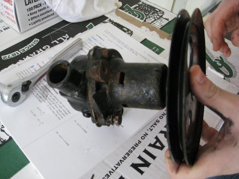

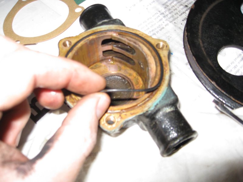

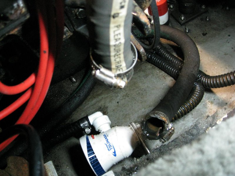

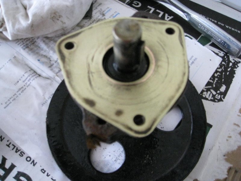

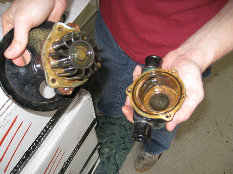

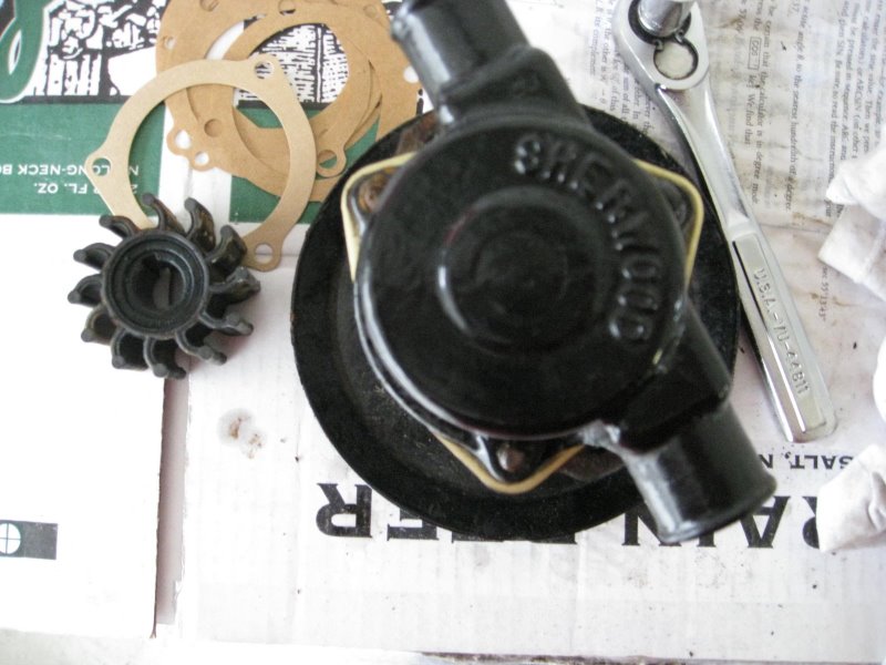

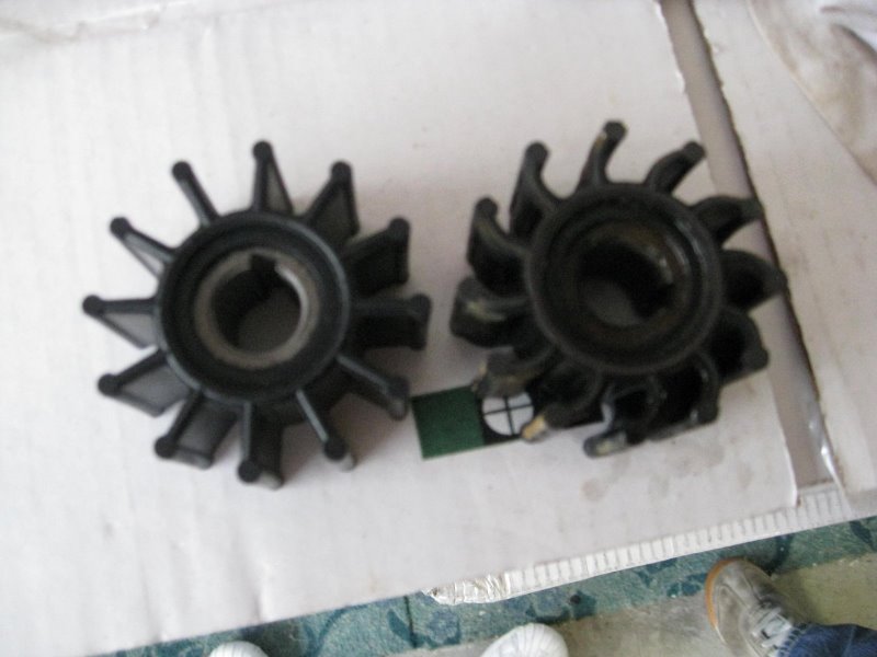

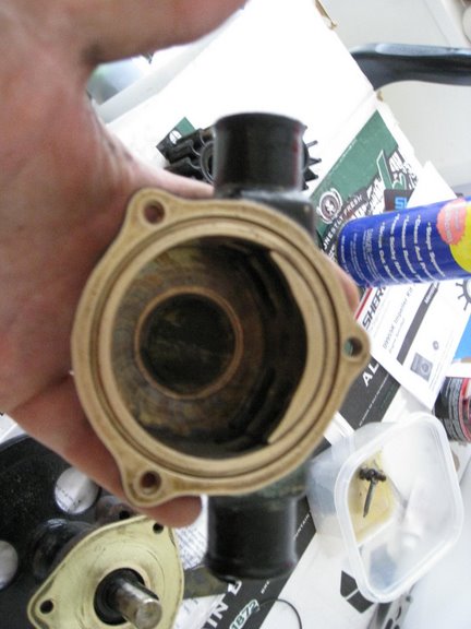

I found some threads on here on how to replace the impeller, but non with pictures. I replace ours last weekend and took some pictures of the procedure.

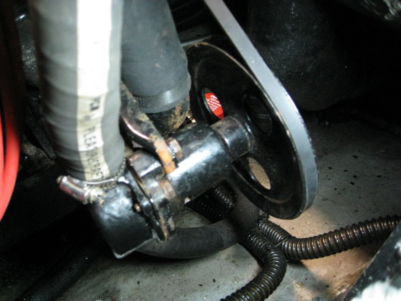

1) Remove (2) 1/2" bolts connected to mounting bracket
