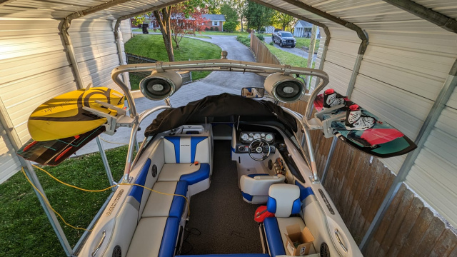

              At one point I had some early Roswell swivels mounted on machined aluminum adapter plates to mount Mastercraft clamping fingers. They worked really well, but were not the most durable swivel setup with all that weight hanging off the end of their custom machined tower clamps.
              My current setup is using the Titan swivels with PTM clamping fingers, these work great for everything from wakeboards and surfboards (under 2" thick), and I am able to carry foils upside down quite well.

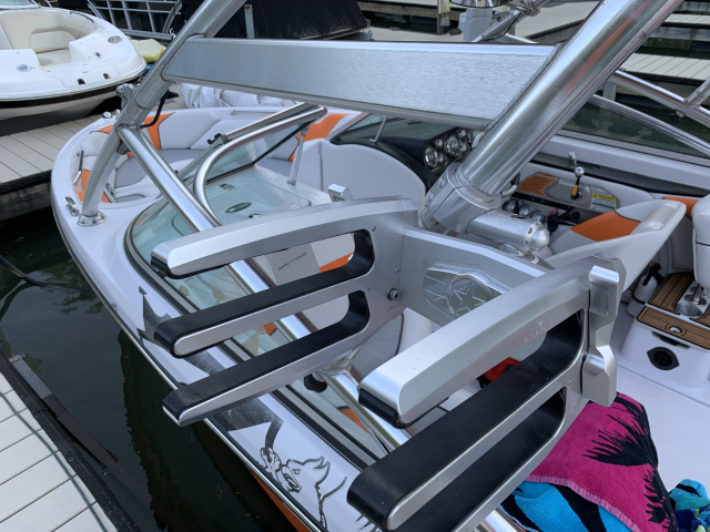

              • Miljack
                • Dec 2004
                • 1634
                • Charlotte, NC
                • '08 230 TE ZR6
                First pic from the transom is not my boat, but shows the PTM tower clamps and racks. Their clamps a very "trick" in the angle on the mount area can be adjusted...2nd pic is my setup on the Titan tower clamps. If I can figure out a way to get the Titan swivels to release from the bottom that would make them easier to use.
