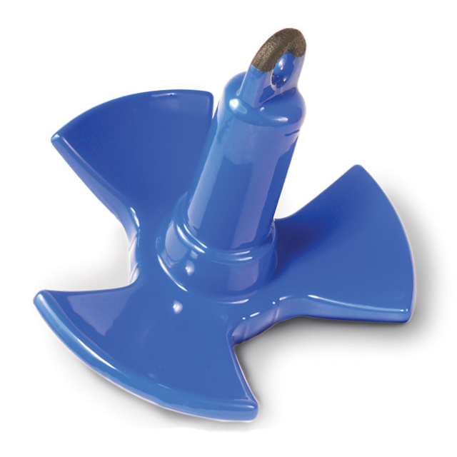

                bturner Hit the nail on the head, "Depends on what and where you use it.". On my home lake in Virginia on Smith Mountain Lake, a box anchor is probably the worst type of anchor to use since so much of the lake bottom is covered with underwater trees which have been in place since the lake was filled and formed in the 1960s.. I have used a Greenfield River Anchor with great success over the years at SML for the reason stated above.
                Click image for larger version  Name:	River-Anchor-Greenfield-Products.jpg Views:	0 Size:	73.7 KB ID:	671640

                  Good job GMLIII, you found my jet ski anchor, I wondered where I left that...
