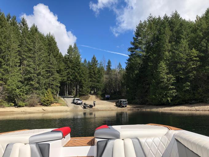

                            Getting out isn’t to bad just a slow ride up the hill. This ramp is absolute garbage, the paved part is falling apart so you gotta go in the compact sand next to it and hard sand is a wee bit slippery. With all of that it’s probably a good 150ft of super steep and then at the last 30 you gotta go to the side off the concrete. Once the boat is in the water of course you stop. Our boat is also really heavy, with lead we are most likely over 9k. Usually we use the private club ramp which is a little better.
                            Whenever we go to the big city ramps I’m in heaven.
                            • Wake.BC
                              • Jan 2016
                              • 423
                              • BC, Canada
                              Probably doesn’t look as steep in the pictures. Water is higher here too.
