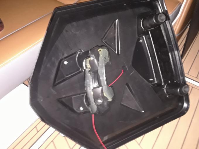

      - Cover literally "glued" to engine block. They care about putting an LED and then GLUE it to the block! Literally lipstick on a pig
      While this is certainly possible, I doubt this is the case. The engine covers are glued to the mounting bracket that attaches to the engines with four push pins that pop into place. If the engine cover is pulled up in a certain way, the engine cover can disconnect from the mounting bracket for the cover, leaving the bracket on the engine with the cover coming off. Maybe stronger glue should be used, but your engine cover in all likelihood was not glued to the engine. Even so, this is a PCM issue, not a Nautique issue.

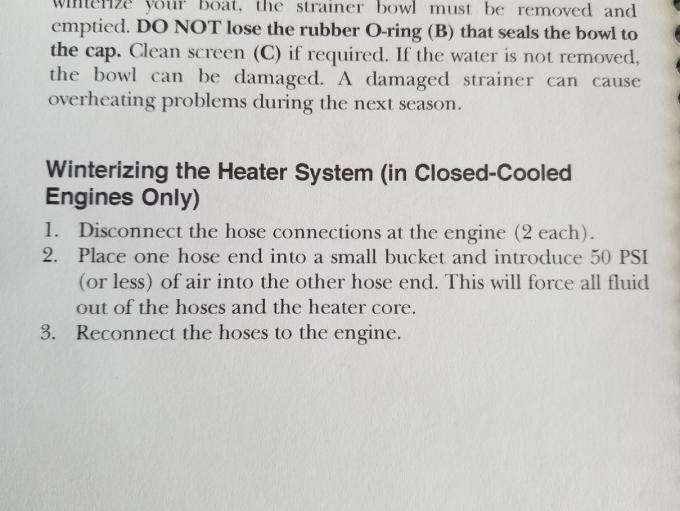

        BTW, isn't the PCM engine on my boat an "open-cooled" one? The manual states that only "closed-cooled" engines need heater winterizing (see attached).

          That's certainly an incorrect statement in the manual, as discussed in your original thread about the heater.

            Thanks Jeff. On the glued cover. Please see picture attached. The dealer confirmed they use epoxy glue. Also just posted a misleading section on their manual about heater winterizing. Sorry the break the spell for some here...

                  Just FYI, our boats are held together with epoxy - the liner is epoxied to the hull, then the deck is epoxied to the lower section - there are no through bolts or screws holding this thing together. Using epoxy on an engine cover might sound unusual but at least it's easy to repair.
