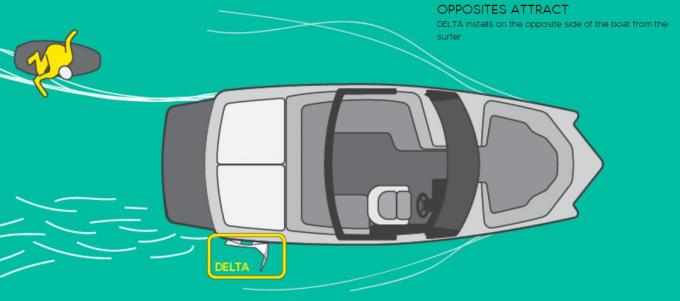

                Also the position of the Delta makes a difference. From their web site:
                Note that the "paddle" is forward of the stern.
