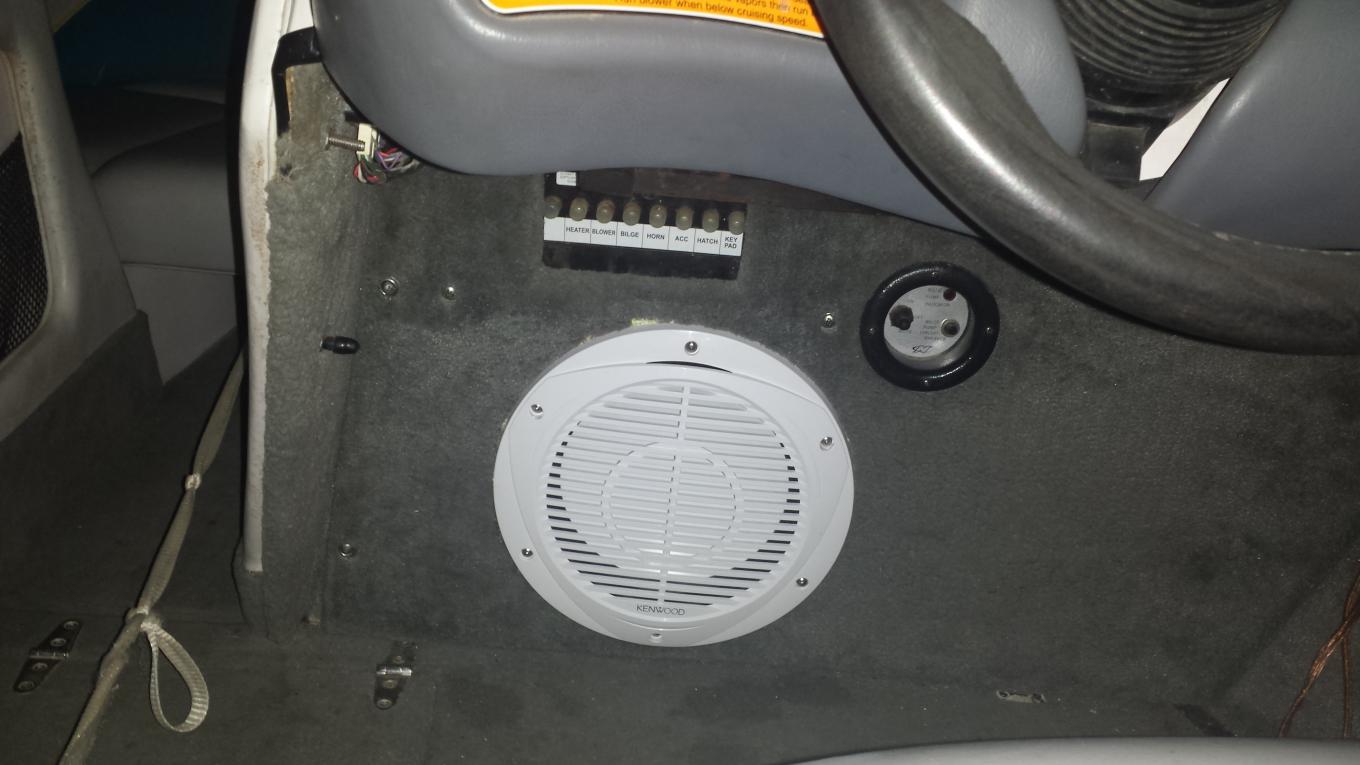

http://www.planetnautique.com/vb3/at...0&d=1401763731Originally posted by DLafont View PostEver since I read about this switch on this forum, I've been trying to find it on my boat and can't locate it anywhere... I'm starting to guess that the switch was introduced/added after 2000 model year.
The black circle to the top right of the speaker under the helm; this is an '01Ken
