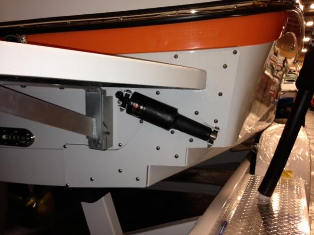

There you go, Keep in mind we painted the top plates of the NSS white. Standard is bare aluminum. We are giving NSS priroity to sold boats currnetly. As Dave P said, Nautique is overwhelmed with the demand for these kits. I will give an update as soon as we get the 210 or 230 on the water. It's cooooold in Indiana.
That looks great. Might even look better in orange to match the accent color on the boat. I'm sure it's a little complicated to paint as to not interfere with the plate deployment. If you have a chance to get video of the wake when you get on the water that would be incredible.Originally posted by Zach@n3 View PostThere you go, Keep in mind we painted the top plates of the NSS white. Standard is bare aluminum. We are giving NSS priroity to sold boats currnetly. As Dave P said, Nautique is overwhelmed with the demand for these kits. I will give an update as soon as we get the 210 or 230 on the water. It's cooooold in Indiana.

I am not sure how many holes go through the transom but if you look at my 4th pic here (http://www.planetnautique.com/vb3/sh...592#post199592) during the build that there are only 3 holes through the transom early on on the sides. I am not familiar enough to say if it is just the platform holes or if those include the NSS. We will have an NSS installed on ours.Originally posted by rsess View Postcan someone please tell me how many bolts go through the transom. That installation looks like swiss cheese although i would hope most are only through to the back plate.
