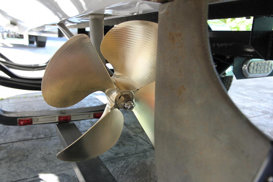

In case anyone is still tracking this thread (or interested), I tried out the 2407 5-blade this weekend. (I'm the new owner of the PN boat).Originally posted by OKWAKEBDR View PostI have another 5-blade on its way to me to test out. Acme Part #2407 13.5 x 14.5 .060 cup 5-blade.
I did to get precise measurements like Jeff did because I took the prop off after about 1 hour - that is how bad it was. With no ballast, it was okay, although it maxed out at 38 mph. However, when I loaded up all the ballast (approx 3k lbs) it would not get on plane. I dropped about 1k lbs out of the back and was able to get it going, but it cavitated very bad when i slammed the throttle. I had to ease into it to keep it from doing it. It does run about 300 lower rpms at wakeboarding speed than the 1617. After a couple sets with my buddies, I put it back on the boat lift and put the 1617 back on. With it, I had no problem getting the boat up with all the ballast and 5 guys in the boat (no one sitting in the bow). The 1617 is only running about 3600 rpm with full ballast at 23 mph with the wake plate on 3. With the wake plate on 1, the rpms drop by about 150.
The 5 blades just do not seem to perform on nautique (so far anyway).
I'm really pleased with the 1617. I do not want to run the 14.5 inch diameter 1235, so I can't comment as to whether it performs any better. Even if the 1235 does run better, it's just not worth the prop burn risk to me when the 1617 does everything I ask it to do.Last edited by OKWAKEBDR; 10-07-2012, 09:59 PM.Current: 2017 G23
