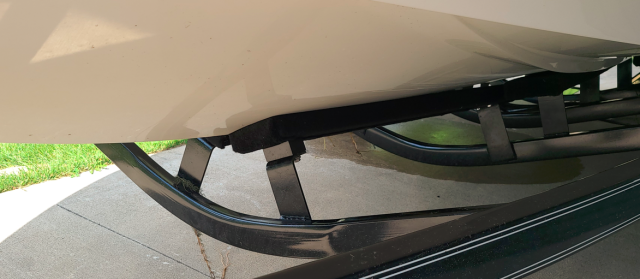

I went looking for the pictures I took of the trailer and the blocks we cut and could only come up with this one. I had my BIL who owns a machine shop machine blocks from 1" going to 2" thicknesses, then tried them while at the ramp one weekday when we knew the ramp would be vacant. Not a lot of fun but it did work. The picture below is of what I'm thinking was the 2" block in the front before adding what if my memory serves me correctly was a 1" rear block. As you can see in the picture adding the block does 2 things, it obviously lifts the bunk but it also closes up the "V" which will push the bow up much earlier in the loading process even if the front of the bunk isn't touching when the boat is loaded. The goal is to have contact for support but not going too far where the front bunk is taking too much of the load.
I would have much rather cut the old supports off, fabricated new ones and welded them on but believe me when I say, no one wants the kind of welding I do on their trailer. In the end these guys have been installed for 4 seasons now without any issues.
Wish I would have taken more/better pictures of the blocks as he did a great job with them. The blocks were lagged to the bunks in counter sunk holes. The blocks were drilled and tapped then bolted to the trailer brackets. Everything is stainless. Way overkill for shimming blocks but when the owner of the trailer owns a machine shop and you can get some of his time, this is what you end up with.
