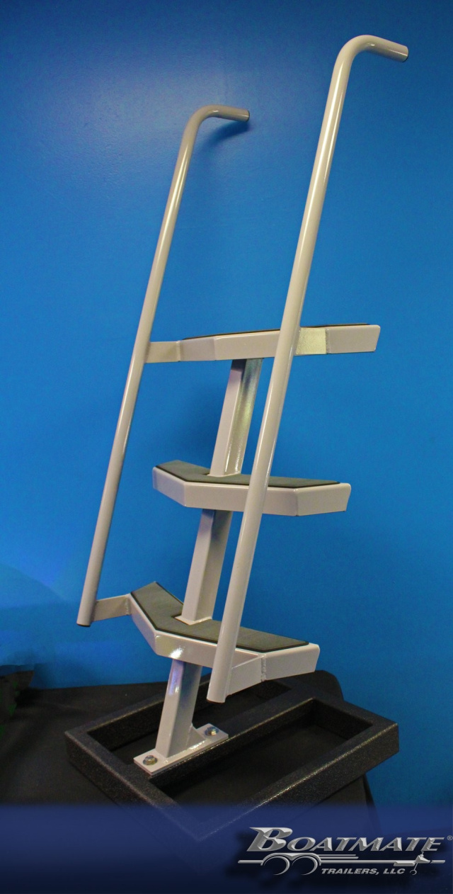

    Factory Boatmate Rails
    Click image for larger version  Name:	Factory.jpg Views:	0 Size:	243.9 KB ID:	684956

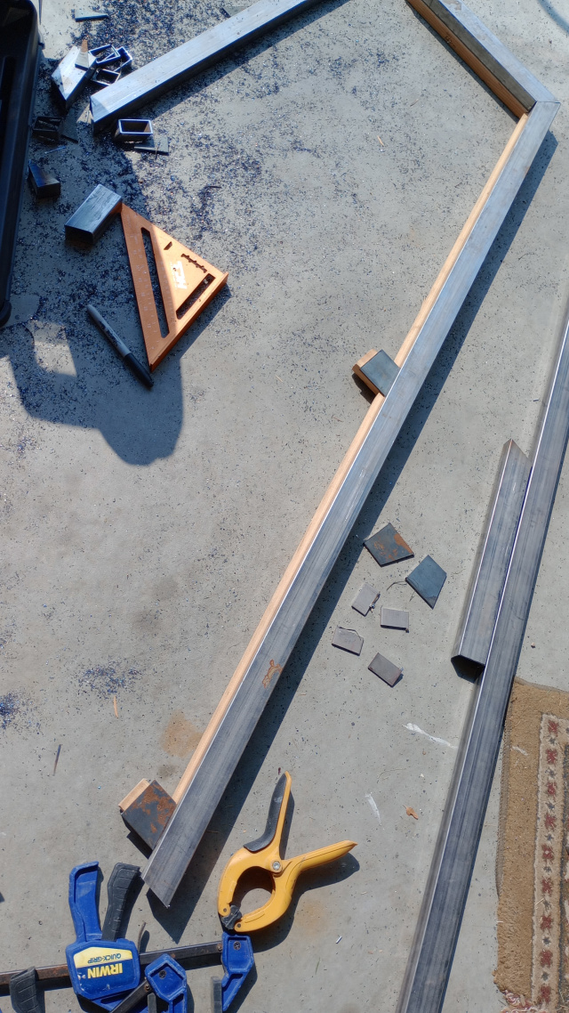

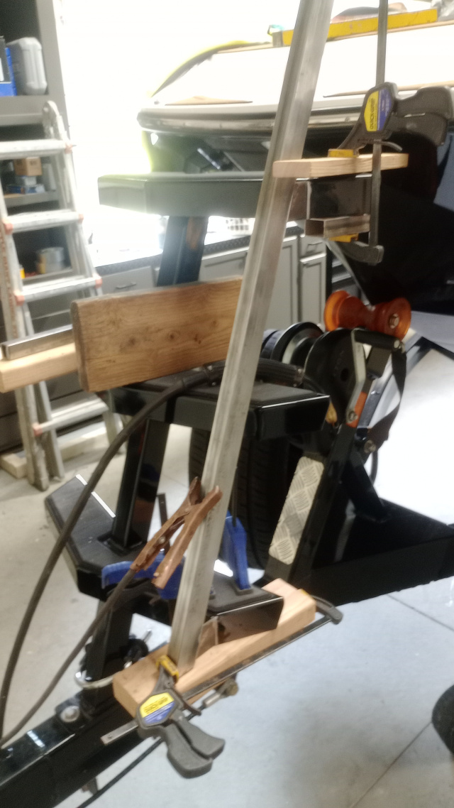

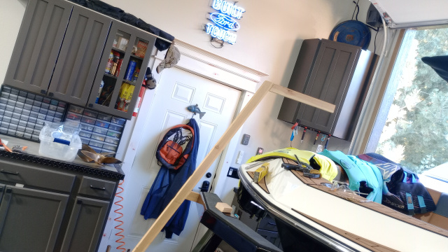

    1st step, let's jig this out and see what it looks like
    Click image for larger version  Name:	IMG_20240906_191602.jpg Views:	0 Size:	297.1 KB ID:	684940
    Click image for larger version  Name:	IMG_20240906_191514.jpg Views:	0 Size:	129.7 KB ID:	684941

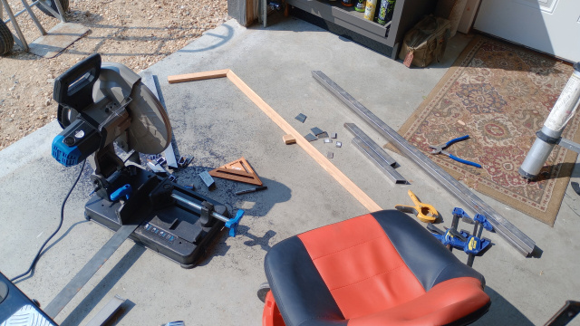

    I had a few rails of 1 1/2 x 1" stock laying around, put it to use, cut & chop
    Click image for larger version  Name:	IMG_20240907_120526.jpg Views:	0 Size:	140.5 KB ID:	684942

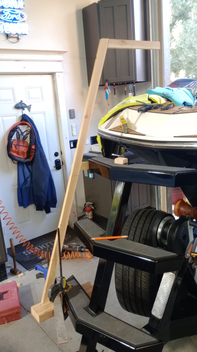

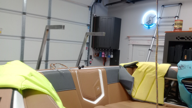

    Positioning for fit. I think the factory rails look a little wider spaced, I wanted these a little tighter.
    Click image for larger version  Name:	IMG_20240907_143839.jpg Views:	0 Size:	70.6 KB ID:	684944

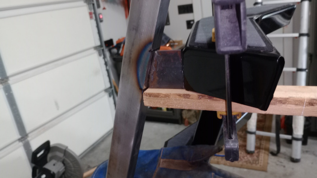

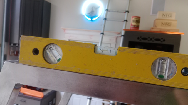

    Ready to tack, eyeball & measurements for straightness, redneck accuracy
    Click image for larger version  Name:	IMG_20240907_171959.jpg Views:	0 Size:	224.4 KB ID:	684945
    No turning back now
    Click image for larger version  Name:	IMG_20240907_191041.jpg Views:	0 Size:	251.1 KB ID:	684946

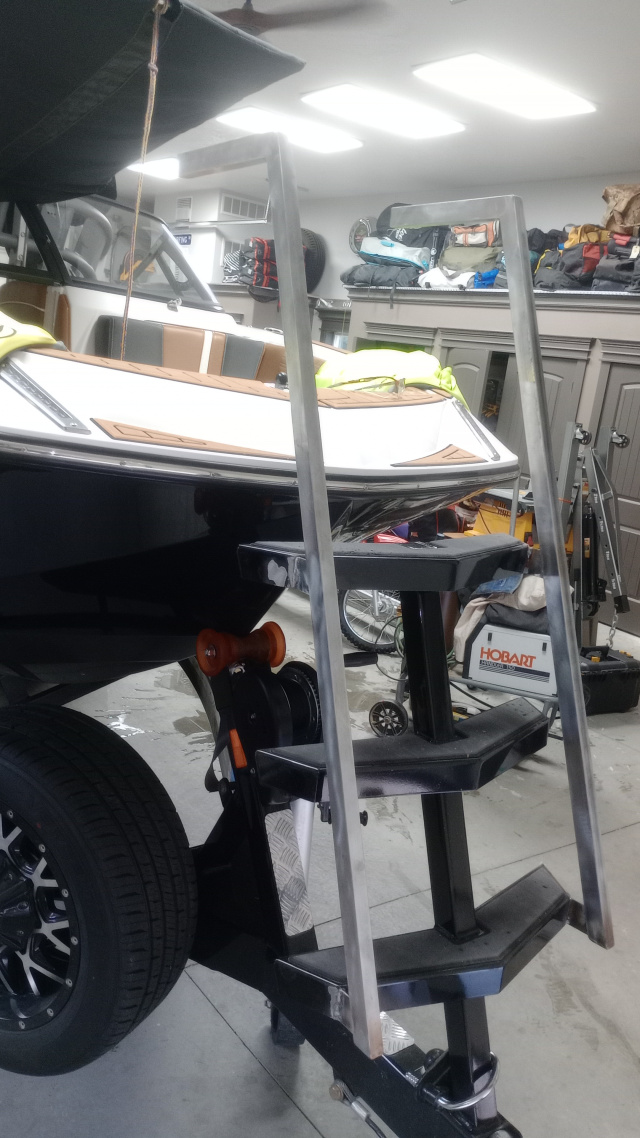

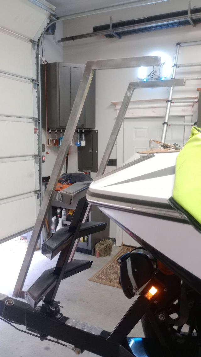

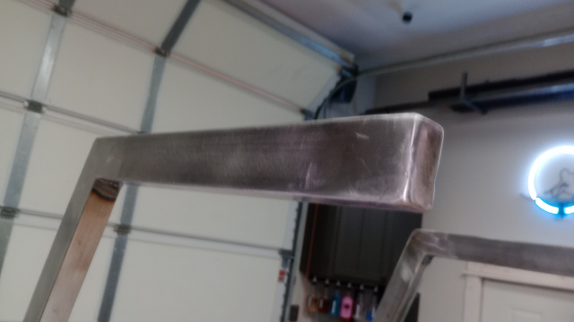

    Pleased with the height, very comfortable for entry & exit
    Click image for larger version  Name:	IMG_20240907_191419.jpg Views:	0 Size:	88.0 KB ID:	684947
    Click image for larger version  Name:	IMG_20240907_191150.jpg Views:	0 Size:	217.6 KB ID:	684948

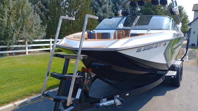

    A few different angles if you decide to replicate
    Click image for larger version  Name:	IMG_20240909_144922.jpg Views:	0 Size:	146.5 KB ID:	684950
    Click image for larger version  Name:	IMG_20240912_203825.jpg Views:	0 Size:	219.9 KB ID:	684951
    Click image for larger version  Name:	IMG_20240912_203723.jpg Views:	0 Size:	263.0 KB ID:	684952

              jhiestand, I've got to say, that is better than nothing. I saw one other pre-fabbed model out there that looked pretty worthy. I know you can buy the whole bolt on assembly from Boatmate, but would hate to think what the cost is, saw it on their Facebook.

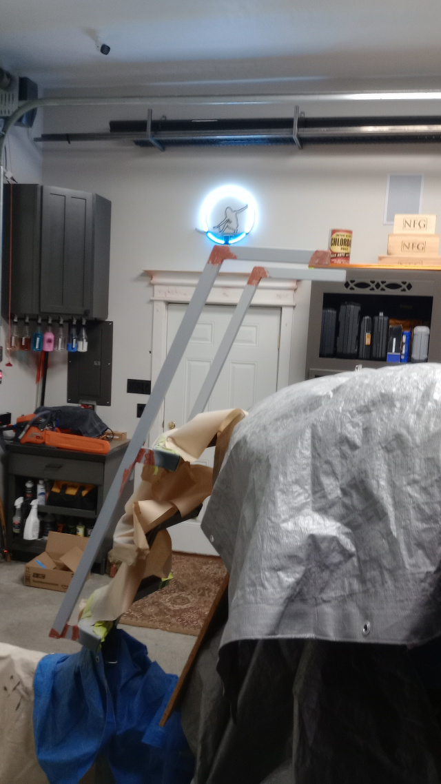

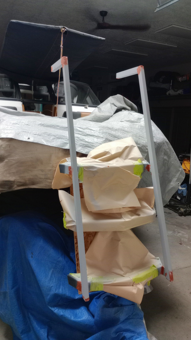

                    I'll hold onto the would jig for a while if anyone would like it, you grab the shipping.

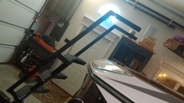

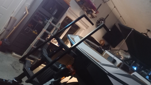

                    A little primer& spot putty, 3 coats of Boatmate rattle can black, I like the end results. The Captain made me cover most all of the boat before the spray flew. I think there may be some underlying previously documented trust issues here, not sure, lol.
                    Click image for larger version  Name:	17.jpg Views:	0 Size:	266.4 KB ID:	680500
                    Click image for larger version  Name:	19.jpg Views:	0 Size:	96.3 KB ID:	680501
                    Click image for larger version  Name:	21.jpg Views:	0 Size:	115.0 KB ID:	680502
                    Click image for larger version  Name:	20.jpg Views:	0 Size:	84.7 KB ID:	680503
