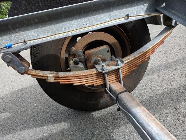

      As the trailer was used in salt and you have brake issues, I'm going to guess the calipers and discs are shot and will need a full replacement. Factory rated salt water trailers typically are equipped with aluminum brake components and have fresh water post use flush kits installed. Again, pictures will help. For reference, I attached a picture of a saltwater used trailer with non-maintained disc brake system...this was from a boat I was inspecting for possible purchase. This trailer needed a complete braking system replacement.

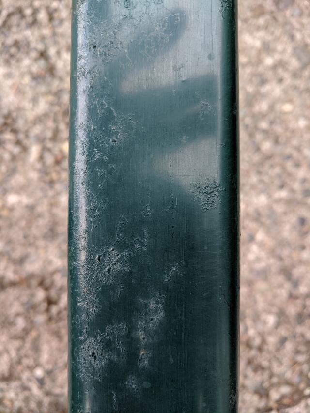

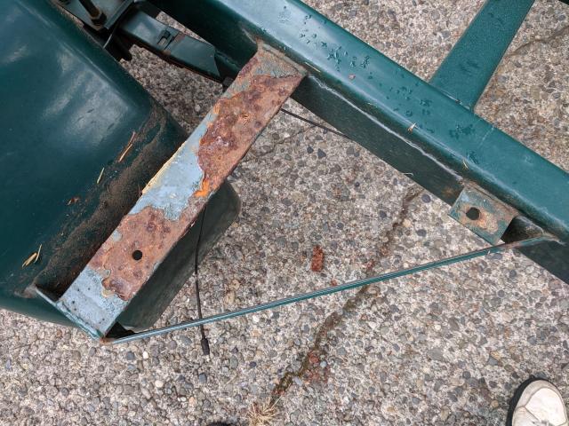

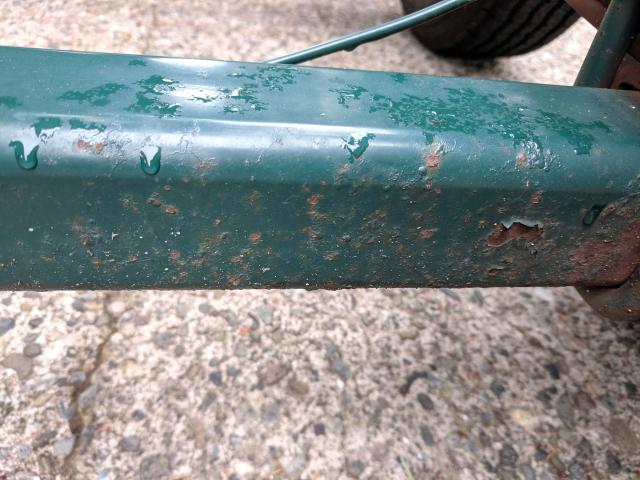

        A few pictures of my '97 DHM model trailer driveway repaint.
        Examples of rust damage prior to the work
        Click image for larger version  Name:	IMG_20190811_095639.jpg Views:	0 Size:	69.1 KB ID:	668125
        Click image for larger version  Name:	IMG_20190811_101053.jpg Views:	0 Size:	55.0 KB ID:	668131
        Click image for larger version  Name:	IMG_20190811_103920.jpg Views:	0 Size:	79.9 KB ID:	668130

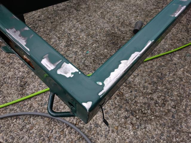

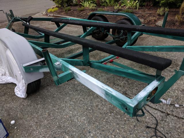

        Surface prep
        Click image for larger version  Name:	IMG_20190811_140036.jpg Views:	0 Size:	68.4 KB ID:	668128
        Click image for larger version  Name:	IMG_20190811_131128.jpg Views:	0 Size:	74.6 KB ID:	668129
        Oddly, no pictures of the final product. I used off the shelf rustoleum spray paint as the color was quite close to the factory color. Trailer looked great when finished.
