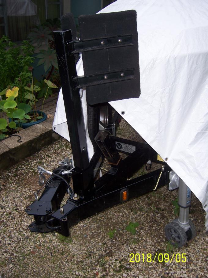

I have a Phoenix with a bow roller and hated it Some steep ramps - Norris comes to mind, the roller was over and almost hitting the bow light. After that I had enough and figured I'd do something. Found a used Ramlin assembly and went from there. One could be made up but I lucked out finding one so it saved some work. The original Ramlin system had a pin you would remove tilting the pads forward to allow you to put the cover on which I retained. Here is the original roller system-

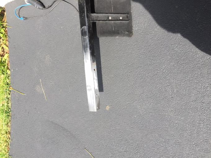

I had to extend the original by about a 9" since the boat on a Phoenix must sit higher. Here it is welded and primered.

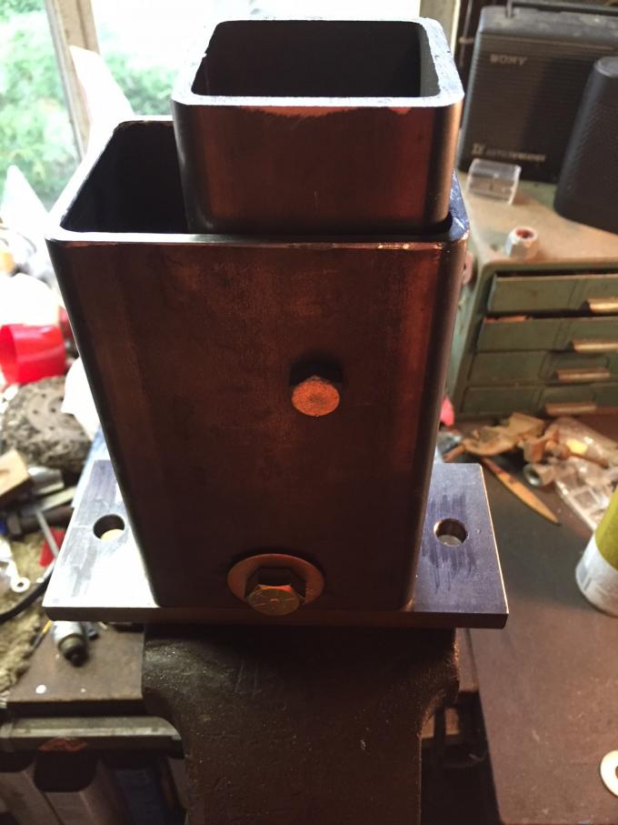

This is the attachment to the trailer I made and had welded up,with the pad extension mounted in it before being welded to the main pad frame. You pull that small pin and the pad part tilts forward.

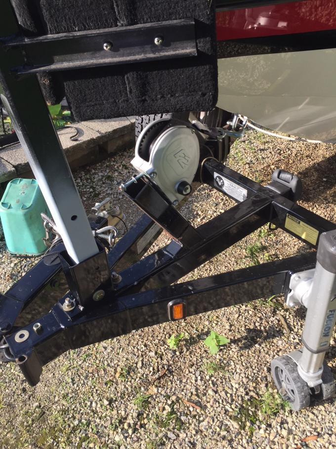

Here it is with the pin pulled and in the forward position. Also is where I mounted the winch.
Works great for me so far

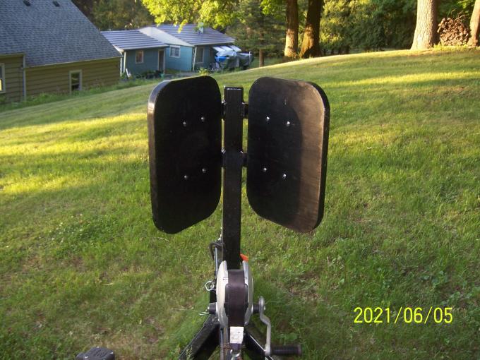

Made plastic pads last year since the plywood carpeted ones were falling apart
